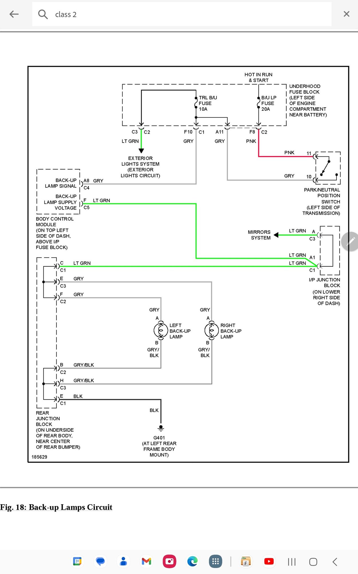

Hope this helps.

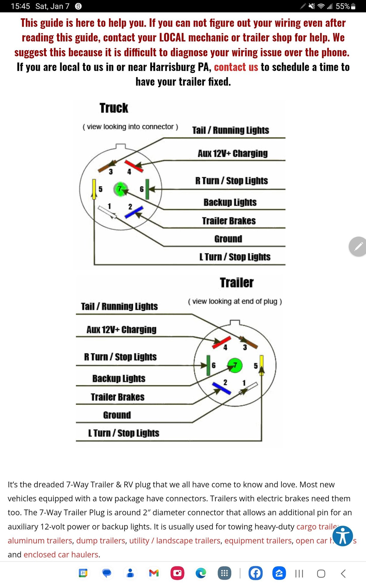

there should be reverse at the tow connector on the bumper

If you are looking for reverse power in the rear, the 7 pin trailer/tow connectors typically have backup (reverse) power on the center (#7) pin. That worked for power when I added a camera to my H3. Probably the same on the H2 (mine isn't home right now to verify). If you need it to energize the interior/dash monitor then the previous dash area schematic should help.
