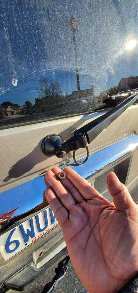

Hello guys
any idea how to remove the rear wiper arm? I remove the nut but still wont come out. I hate to yank it I might damage the motor.
I took this nut out but still cant get the arm out, any idea? Thank you.

Just flip the arm up and firmly keep rocking it back and forth and it should eventually come loose. They end up getting on there pretty tight....

I had the exact same issue... I sprayed WD40 on it... waited 24 hours, then it slid right off

I sprayed wd last night hopefully will come off easily.
