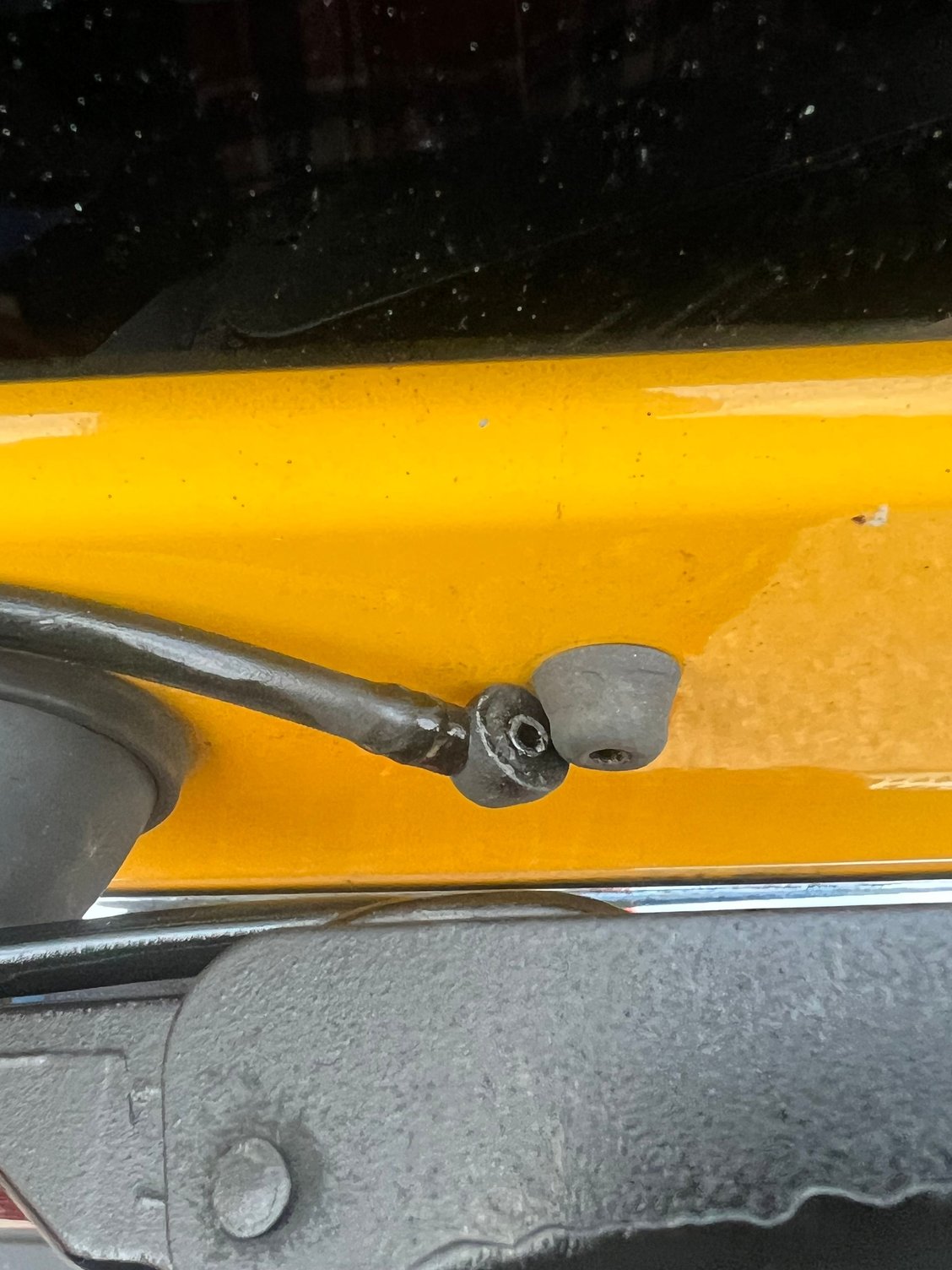

Hi I noticed my rear wiper nozzle is broken. What is the best way to repair this? I don’t necessarily use it, but I would like it to either be fixed or to look finished and not broken. Thanks for the help.

That looks like the little 90° piece that comes through the rear hatch. If you remove the inside panel carefully..... Difficult sometimes with that breaking one of the snap-in tabs..... I would remove the 90° piece and most auto parts stores will have something that matches it. Probably the same year Tahoe or Escalade or suburban. You might have to reuse the rubber grommet.
