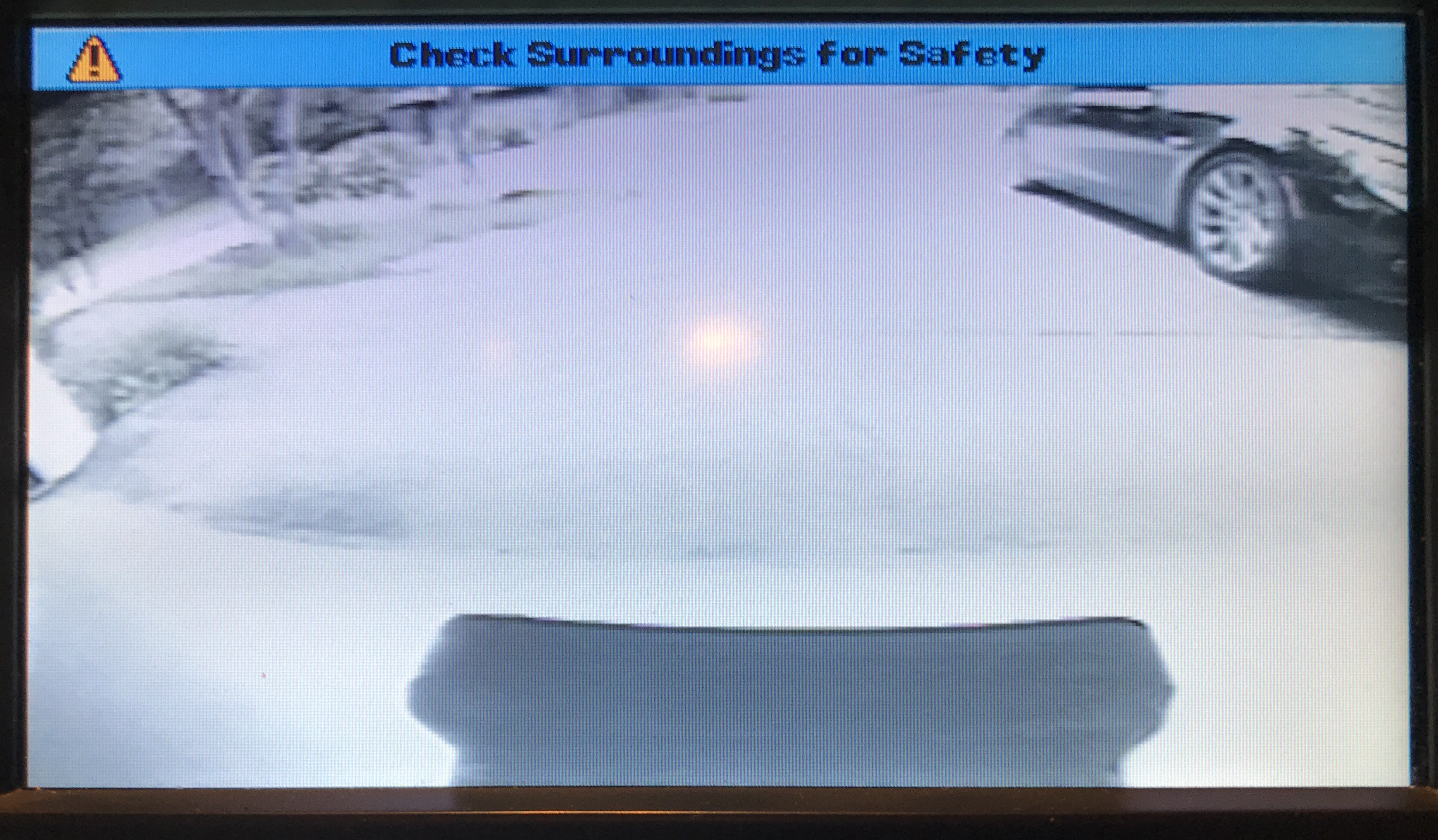

2) My truck has the factory touch screen navigation system with back-up camera. The back-up camera comes on just fine when put into reverse but the image on the screen is very, very bright and washed out like you might see if a brightness adjustment is turned up all the way. I checked the brightness and contrast adjustments and they don't help the problem. The image is so bad it is barely even usable. I am hoping it is the camera which I could replace easily, and not the head unit. I want to keep the stock head unit and not install an aftermarket unit. It works and I like the navigation system, except for the back-up camera image being so bright and washed out. See pic here. Anyone else have similar issue with back-up camera on an '08 or maybe an '09? Any help is appreciated.

As for your seat issues, I have no idea since mine is an 06. I have no experience with 08/09s. Although, it sounds like your backup camera may be bad since messing with the settings didn't change the picture. If the picture is normal on the stock head unit through all the other functions then I would say it is the actual camera itself.
