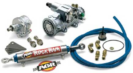

i've ordered the H2 Heavy Duty Rock Ram Steering System from AGR
Attached Thumbnails Power steering pump upgrade recommendation?-agr364351k07.jpg
Did you already installed . How is is the performance. Thx
Old Jan 7, 2017 | 11:07 AM
alamry's Avatar
Joined: Oct 2013
Posts: 46
It'll be delivered soon and I'll post a review after installation on how it perform on my H2 with 38 tires.
Good day, wanted to know how did the "H2 Heavy Duty Rock Ram Steering System from AGR" - perform to date
Old Nov 18, 2020 | 01:42 AM
alamry's Avatar
Joined: Oct 2013
Posts: 46
if installed correctly with fresh fluid and new lines and bleed the system including the power brake booster, it will work as intended. mine works perfectly with 38 MT tires for past 2 years now. it's so smooth i turn the steering wheel with one finger.
There has been a number of premature failures reported but i'm certain it has to do with how it was installed, hence the job is involving with no cutting corners and without doubt one needs the know-how.
