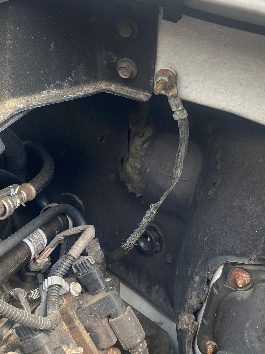

Help I’ve been obsessed with trying to figure this out for way too long lol - I feel like there has to be some related culprit. All parts related to each code have been replaced - the battery has been replaced. It appears that all of the codes have something to do with low voltage, resistance, circuit related, etc….please tell me that there’s a one simple fix that will clear away all of these codes that just keep coming back

I currently do not have the catalytic converter on the vehicle - maybe this is the oxygen sensor codes?
there’s so many other things electrical that do not work - front seat warmers, sunroof
the previous owner did install LED lights- and did a shady job- so maybe this has some things screwed up.
the ground strap under the hood - drivers side - engine to chassis (I think) - is questionable to me - but others have looked at it and said it was just fine
but I have no clue if that particular ground has anything to do with any of the error codes I’m getting…
figured you folks could probably help me out
I guess I’m saying PLEASE help me thanks a bunch - just sayin, be gentle with me if I left any info out
OH 2005 HUMMER H2
235,000ish miles
Ground strap looks frayed and corroded to me?

look to see in the wiring diagram if they share a power or ground. then trouble shoot from there. like what feeds them.

In either case I would replace that Ratty looking Ground lead. Buff out the connection point on both ends. I have see people use a Short battery cable as a ground lead. Not saying this would fix your issue, but Grounds are super important. If you search here one of our experts has posted a full list of grounds and their location as there are allot and immensely important.
