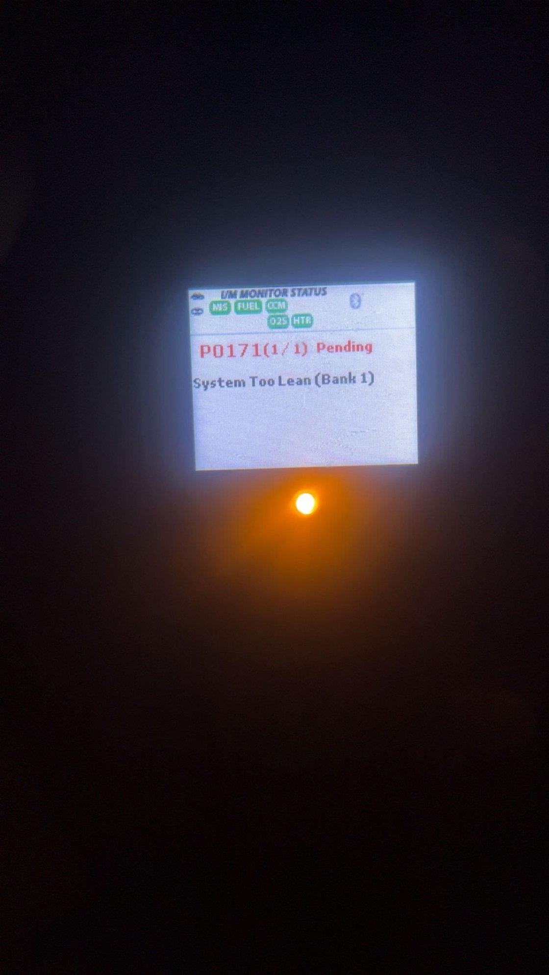

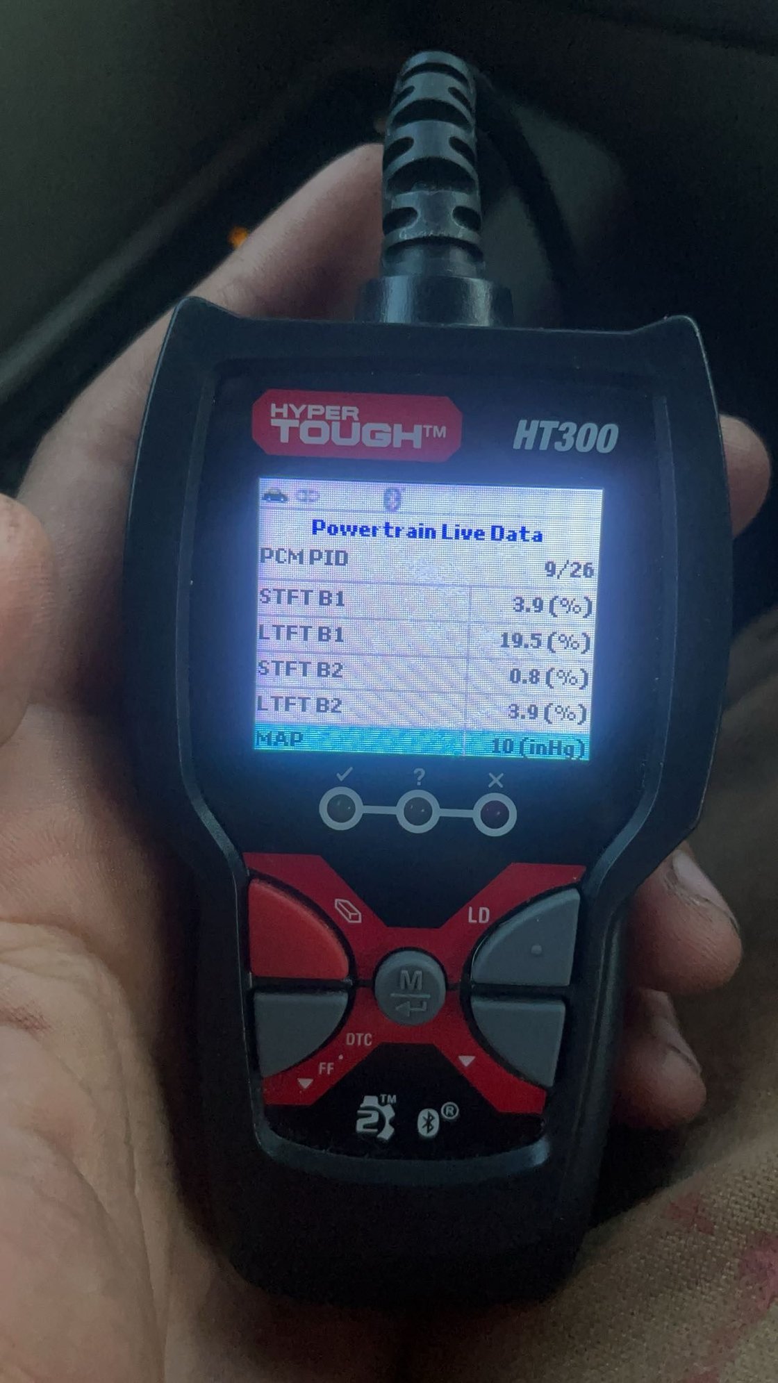

I just recently bought a hummer h2. it was throwing a code for high voltage in bank 1 sensor 2. came to find out someone had cut the bank 1 sensor 2 wire. i spliced and hardwired it back into the connection and am getting proper voltage. the real issue is now that i have done this i’m getting a p0171 code. not once did it ever run this code before i wired it back in, and yes i did the wires correctly. i do have an exhaust leak before the upstream sensor. one at the manifold and one at the flange, but like i said it never threw the code even with that leak until after i wired the downstream o2 back in. what could be causing this? my MAF sensors reading correctly and ive checked every vaccum line i could check to no avail. i’m getting horrible HORRIBLE fuel economy which yes ik its a hummer with the 6.0, but its like 5-8 mpg. LTFT stat at 19.5 when idling, then drop to 11.5 under load. start stay around 2.5 then drop to 0 at idle. any advice or solutions would be greatly appreciate.

I didn’t check them prior since it didn’t throw the code at all. whenever i unplug the 2nd 02 (the one i wired back in) it runs better and only throws a code for the o2 heater circuit. it honestly baffles me, with the 2nd 02 it throws lean code, without it it just throws code for heater circuit. fuel trims still stay high, but i have the battery disconnected right now to hopefully reset fuel trims.

just checked after resetting fuel trims with 2nd o2 unplugged still getting 25% at idle and goes down with acceleration.

do the O2 sensor MV's swing high and low while idling?
most i seen was 0.850 and lowest i seen was 0.090.
