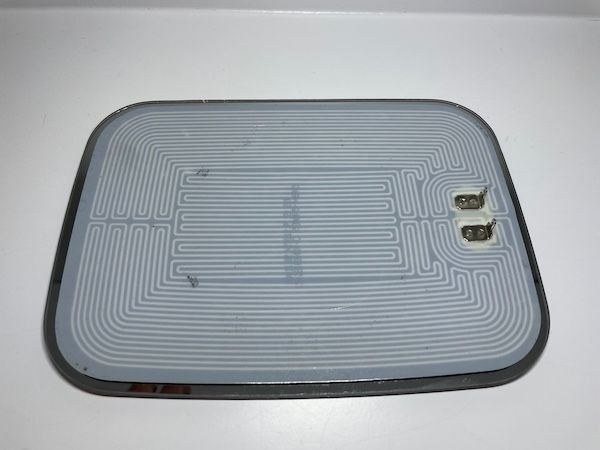

@Mark R I also bought one before hunting down an OEM... it is very nice quality glass. Burco 3746H. I just replaced a mirror and cleaned up the housings this weekend... see thread here
The OEM passenger side mirror only has heat, no dimming. The Burco glass comes with heater connectors required.
Differences:
  • The Burco glass comes as glass only without the plastic mounting plate or rim. This means you need to remove all the broken glass and adhesive from your OEM mirror mounting plate and reuse it. Without the OEM plastic mounting plate, the glass is useless. That plastic mounting plate is not available anywhere.
  • The Burco glass is convex... it is curved... the OEM glass may also be curved... cannot quite tell, but the OEM glass uses a super strong adhesive mat that fully attaches that mirror to the mounting plate. The Burco glass does not sit flat on the plastic mounting plate, but is curved and has a very thin adhesive layer... If your mounting plate is really clean and flat you should be good else you may need some 3M adhesive tape or silicone adhesive to make sure it sticks. I did not trust it... if I can pull it off... I was thinking that gravity would as well.
I happen to have the Burco sitting here... so here are some photos...
FRONT
FRONT
REAR
REAR
SIDE BY SIDE WITH THE MOUNTING PLATE
HERE IS THE MIRROR SITTING ON THE PLATE AND YOU CAN SEE THE CURVATURE

@Mark R Let me know what your situation is... I think your passenger motor is not working correctly but your glass is good. If that is the case you should be able to pull the mirror off the motor without harming the glass. You will see in my other post that the mirror motor broke into two parts way before that factory glass got close to breaking. You should be able to get the glass off your motor safely. The OEM glass is thick .. much thicker than the replacements.
I would not order anything unless you actually have a mirror glass issue! Yes, the 08/09 H2 use the same mirrors.
To pull the glass off the motor... use the controls (if any work) to try to get the top-right edge lifted as much as possible so you can fit 3 fingers under the passenger top right edge. If the controls don't work... then you can force that edge up by pushing the mirror in on the left side and out on the right. Get 3 fingers into the top right edge so you can push from the rear down and out. Use gloves to be safe and wiggle it. Use some blue tape to hold the mirror loosely to the housing so if it pops off it doesn't fall.
