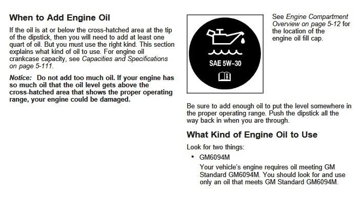

Originally Posted by 2004H2
book calls for 5w20, .
The French version?
2004 HUMMER H2 Owner Manual
