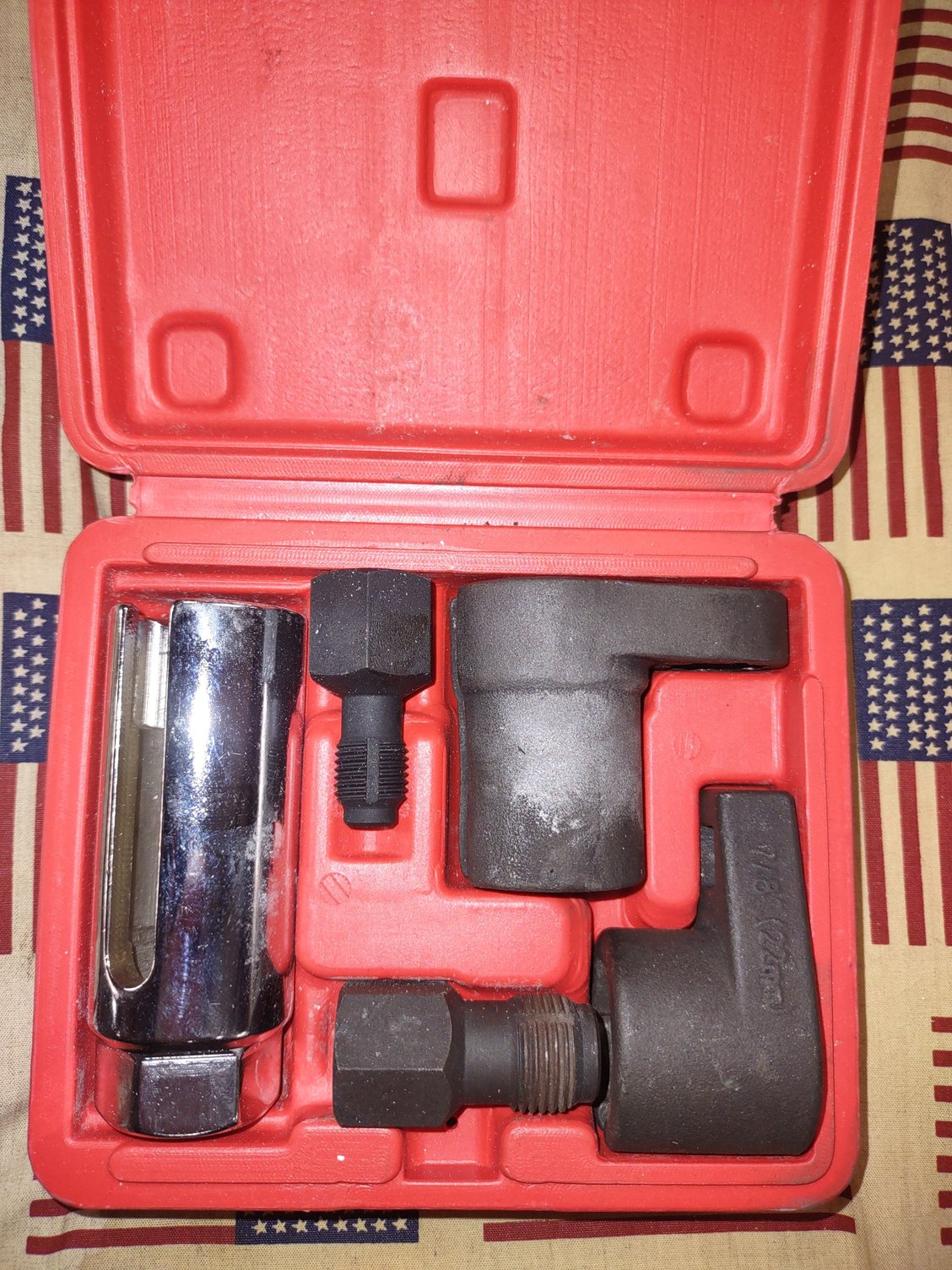

The newer vehicles are more sensitive to using AC Delco or genuine GM sensors. You have two upstream and two downstream sensors. Compared to many vehicles I've had, the ones on the H2 are fairly easy to get to. If you pick up an O2 sensor socket kit, makes it super easy. Includes a thread chaser also to clean those threads. Very affordable at $20.
