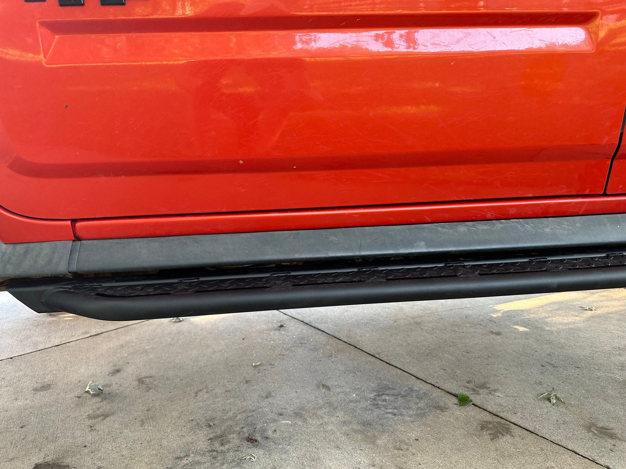

Ill post pictures of what the sliders looked like during and after. as well as the driver side slider as a before(the passenger side used to look just like it). I only got the front wheel off the ground by about 2 inches before I called it quits. The slider was hitting the body just barely, but not enough the cause any damage though the support rails were resting on the pinch welds and the outside rails pushed up the bottom of the plastic cladding just a bit. I’d say it permanently deformed a little less than an inch. The slider is not bent long ways. Just upward about 3-4 degrees. I am not an expert on rock sliders. I don’t know how much bending and warping is acceptable but this seems like too much.
I’m unsure what to do at this point because I certainly do not want to deal with having to freight these back to them, but right now I definitely don’t think they were worth the money or the 4 months of waiting.
Drivers side(hasn’t been lifted from)
Also drivers side
