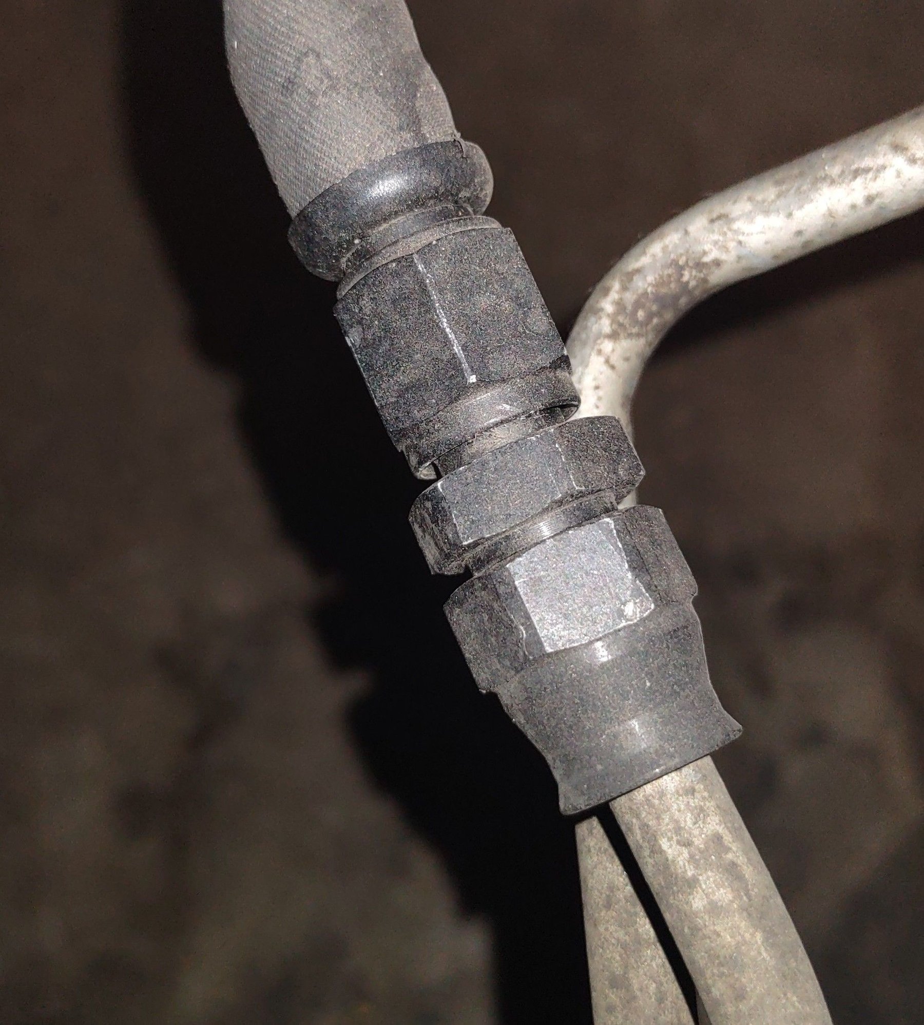

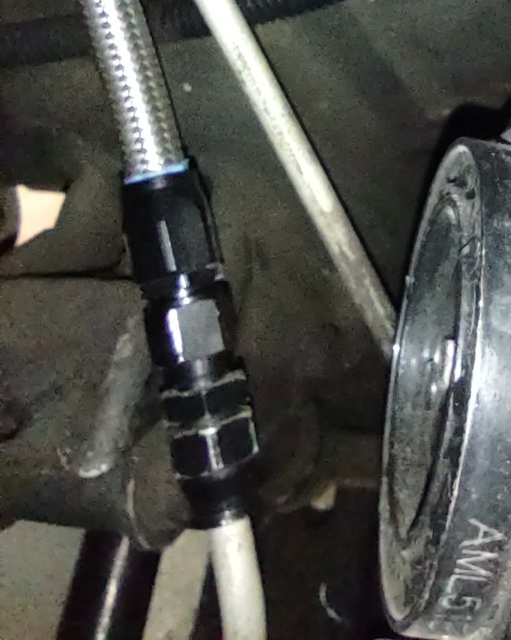

I was just down in the shop and here's a photo of the retrofit I did on the H2 for the transmission lines. You'll know you can either use standard oil rated lines like on the Escalade above, or the steel braided I went with on the H2 which is a bit overkill LOL
