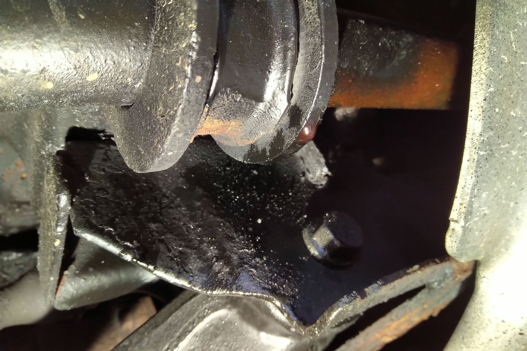

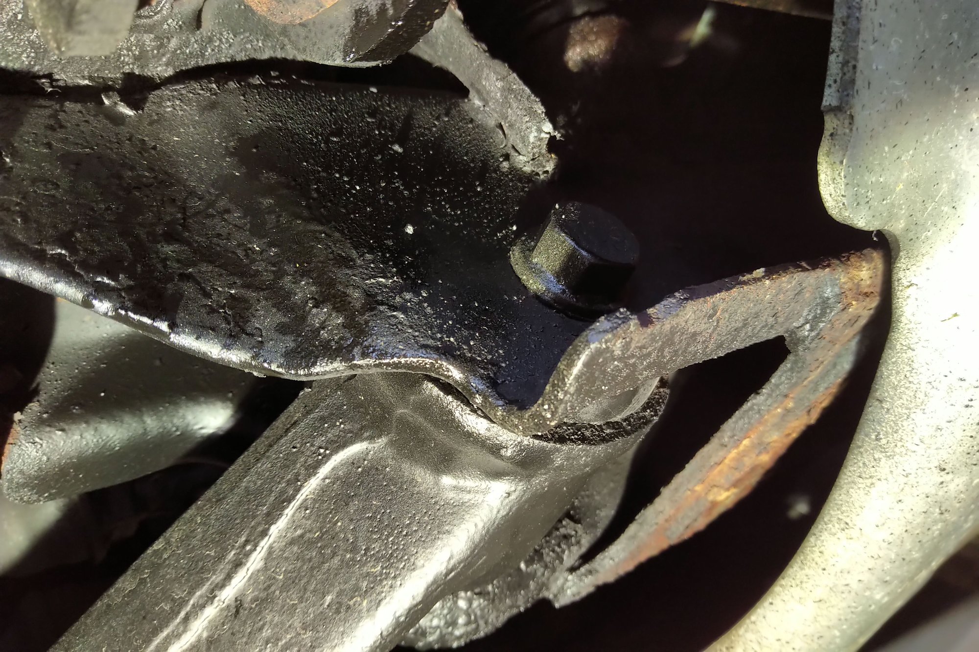

I have noticed a fluid leak under the passenger front - behind the bumper. Appears clear. I will need to investigate that further in the morning. Checked the oil and it looks darker than the fluid on the ground. Will be replacing that regardless.

Well, the choices for fluid leak on passenger side behind the front bumper are fairly limited.
1. Transmission lines going to the radiator
2. Lower radiator hose leaking
3. Coolant overflow bottle overflowing... Or leaking
4. Condensation from the ac lines
Put a piece of white paper on the ground to see what color it really is. If it is in fact clear, it's just condensation running down the metal AC line from the receiver dryer up at the firewall.

Thank you. Further inspection this morning in daylight shows red. Location implies perhaps the trans lines to the radiator.
Trying to attach photos

The newspaper photo was from overnight. Maybe 10 hours.
