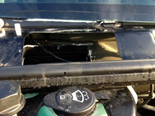

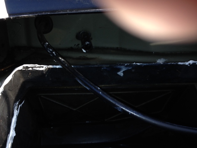

I have an 03 H2 . It had a musty wet smell to it and I started noticing a small water stain in the front corner of the headliner on the passengers side.
I sealed all my roof lights and that seemed to fix the issue then later I started noticing the passenger floor getting wet under the floormat( but the floormat dry).
So next I cleaned and blew out the sunroof drain hoses after which they drained well.
Then today after a hard rain I found the passenger floor flooded!And no, the drain hoses did not come apart or leak when I cleaned them out.
So doing my water hose leak check it seemed like it was leaking when I sprayed the windshield. I thought the windshield might be leaking so I took the cowl off the front (the part over the wipers) and found that the sunroof drain hose comes out the fire wall just above the air conditioning intake for the fan!!
The gasket around this plastic intake opening was pretty bad as well as the gasket for the plastic piece the fits directly over the opening.I've sealed the hell out of all this and will test for water leak tomorrow.
Attached Thumbnails New culprit for soaked passenger floor-hummer-drain1.jpg   New culprit for soaked passenger floor-hummer-drain2.jpg   New culprit for soaked passenger floor-hummer-drain3.jpg   New culprit for soaked passenger floor-hummer-drain4.jpg

Mine is an 03, not sure if the 05 would have the sunroof drain in the same place. My leak came in around the a/c opening, not IN it, so I had major water coming down the firewall under the dash pooling up on the passenger floor.
Dry as a bone now that I sealed that tho.
Fnfal308....If you're getting it on the drivers side you have other issues.
