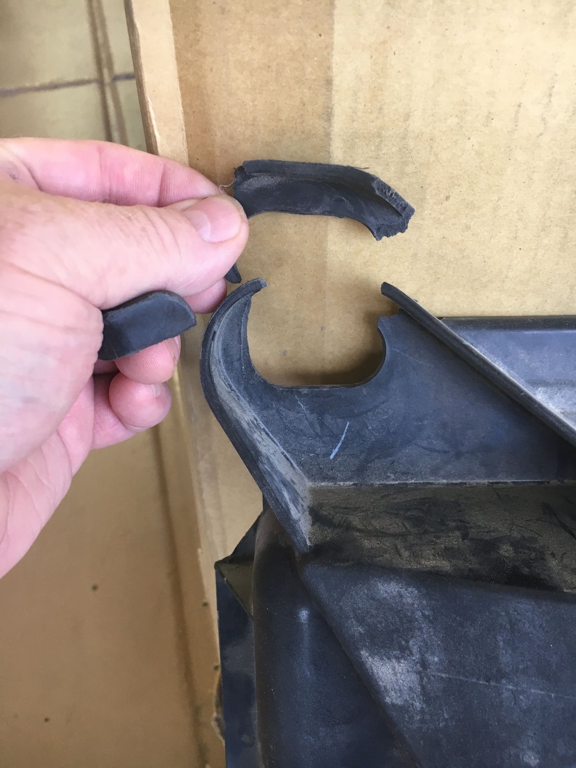

Goes into tank bracket

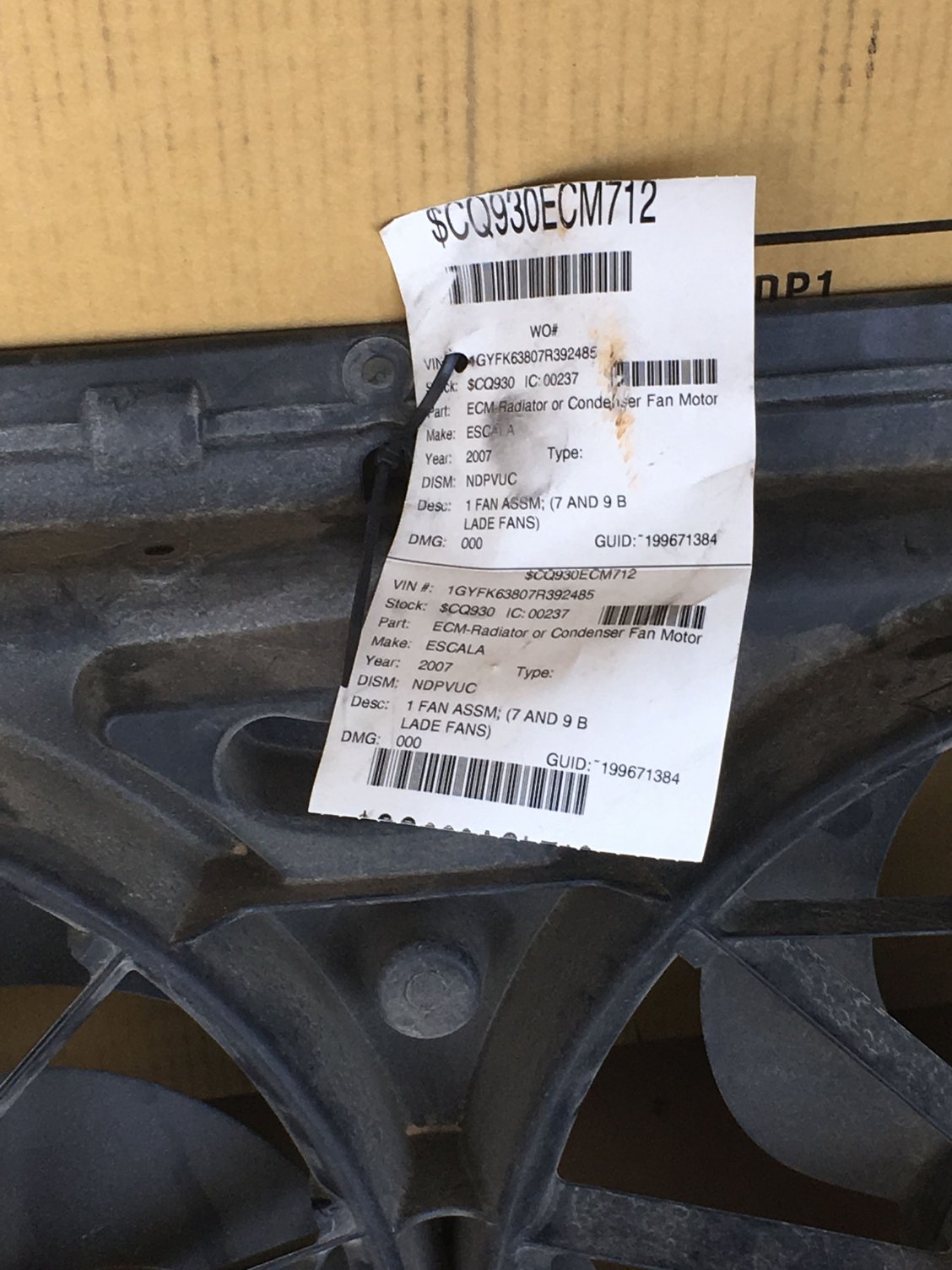

7/9 blade assembly finally
Just now received my 4th fan assembly and I finally got the 7/9 blade assembly that I ordered. It was not packaged very well and the upper mounting hole is broke off and the lower middle part that slides into the radiator tank is broken also. I looked to see if I could put it in the 5/7 assembly but it’s not as HD and a cover over the back of the fan is molded into the 7/9 assembly. I sent LKQ an email and I will see what they say but at this point I bet they think I’m a liar!

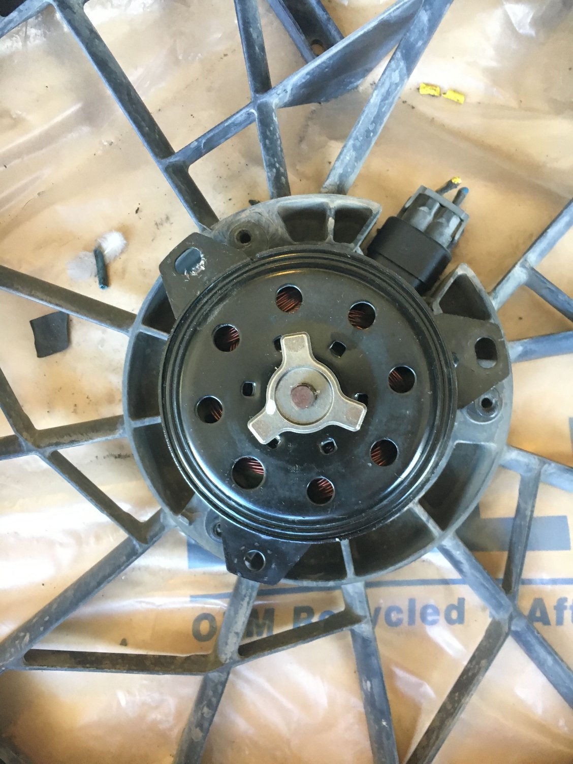

I took the 7/9 blade assembly apart and I cleaned the blades and motors and they look like new. I was surprised how good of shape they were in. I tried to put the 9 blade motor in the 5/7 shroud and it will not fit. The HD motor is deeper and the mounting tabs are in the wrong spot for the plug opening. I could do a 7/7 assembly but after seeing that bigger HD motor I don’t know if I can.
7 blade is on the left 9 blade on the right
