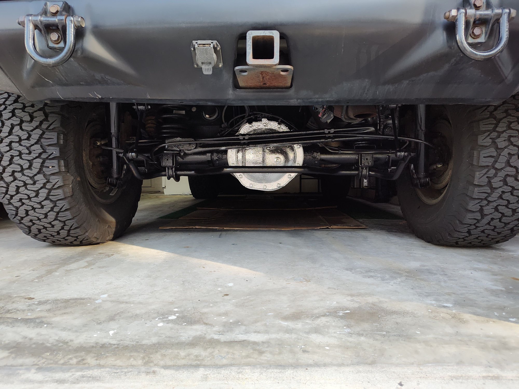

So decided it was time to address some underside issues now that the leaks are all fixed. So painted the front skid plate and rear axel/Diff cover after doing some corrosion control. Noted that the front wishbone bumper stops were "missing". So replaced those as well.
