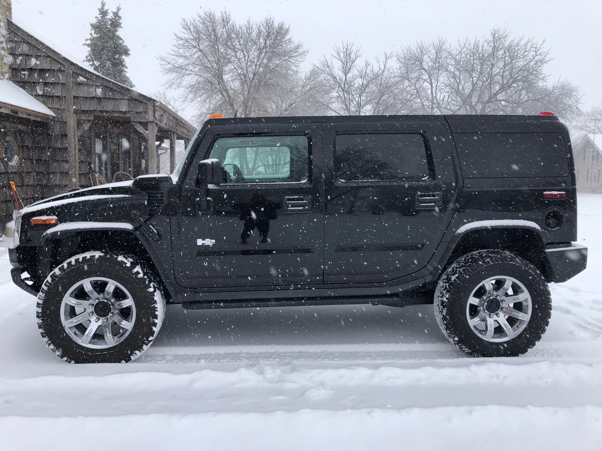

very nice looking H2, congrats
whats that white stuff falling from the sky?
Neal
