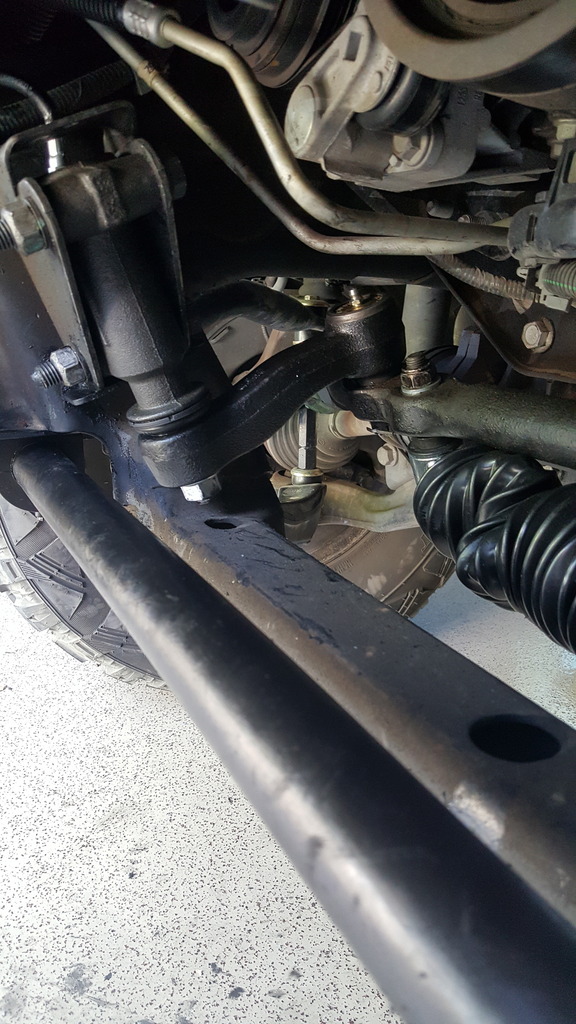

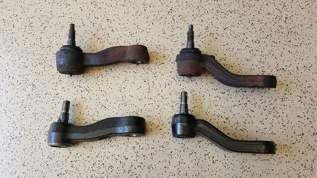

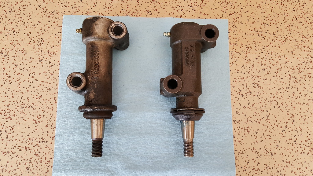

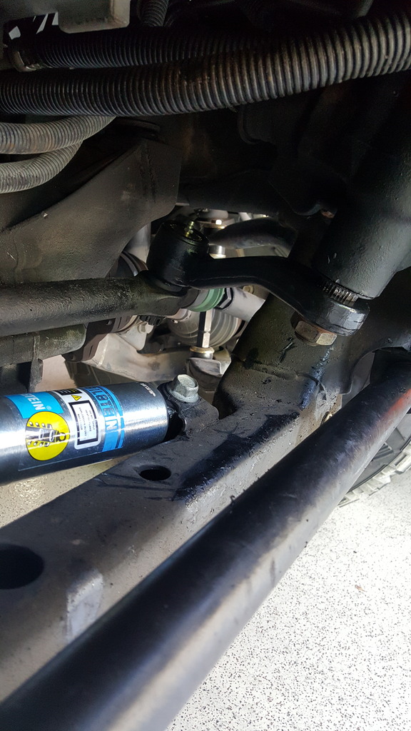

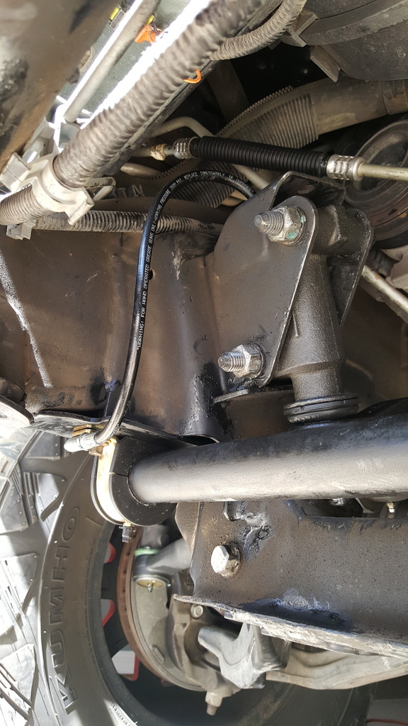

Finally finished up replacing the steering components. I ended up cutting the pitman arm like others have, if you do remove your pitman arm then save yourself the frustration and cut the damn thing.
Here are some comparison photos of the Moog Problem Solver parts and the stock parts. Moog Problem Solver are much heavier duty, you can tell by just the weight alone.
Parts Installed:
Here you can see the additional remote grease hose I installed on the idler bracket. It has a 90 degree fitting at the rear of the idler bracket then runs down and bolts with a sway bar bushing bolt. I never knew the stock idler bracket even had a zerk!

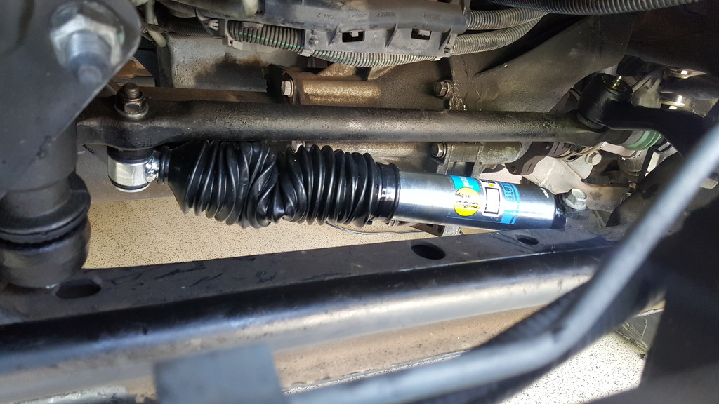

New Bilstein Steering Stabilizer:
My stock parts weren't too bad, idler bracket was leaking and the pitman arm was a little loose but not bad either. I figured since the front was opened up for other projects I might as well change everything. I also painted the tow hooks banner red which you can see in some of the pics.

That remote zerk is a great idea. Why is the Bilstein boot bunched up?
Old Jun 9, 2017 | 11:38 PM
  #49
LoJac963's Avatar
Joined: Jul 2011
Posts: 2,357
From: Surprise, AZ
Not sure, I'm going to mess with the boot. It doesn't collapse on itself like most shocks I've seen. I may buy a better boot and ditch that one.
