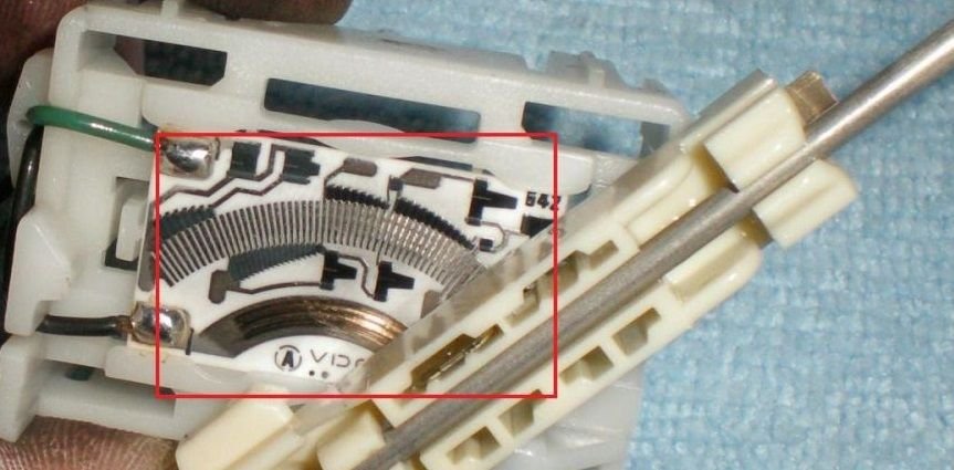

Possibly, if the issue still occurs on a full tank. The lower part of the sender gets excessive wear when users running the tank low and only add a few gallons at a time, as shown here:

Hummerz compare your fuel-guage to the broken ACD part Rock sent, yours looks superior quality, do you its P/No and/or Manufacturer?
Old Sep 21, 2019 | 09:08 AM
The pic was for reference('04 A4), I've replaced many that were far worse.
No sign of any wear on your sender.
I just filled up and it it reacted as it should and came up quickly. I never let my vehicles run below a quarter and usually fill it at 1/2. It seems ro me that vehicles run better on the top half and its cheaper to fill. Thanks for the reply and pic. Most likely my issue.
