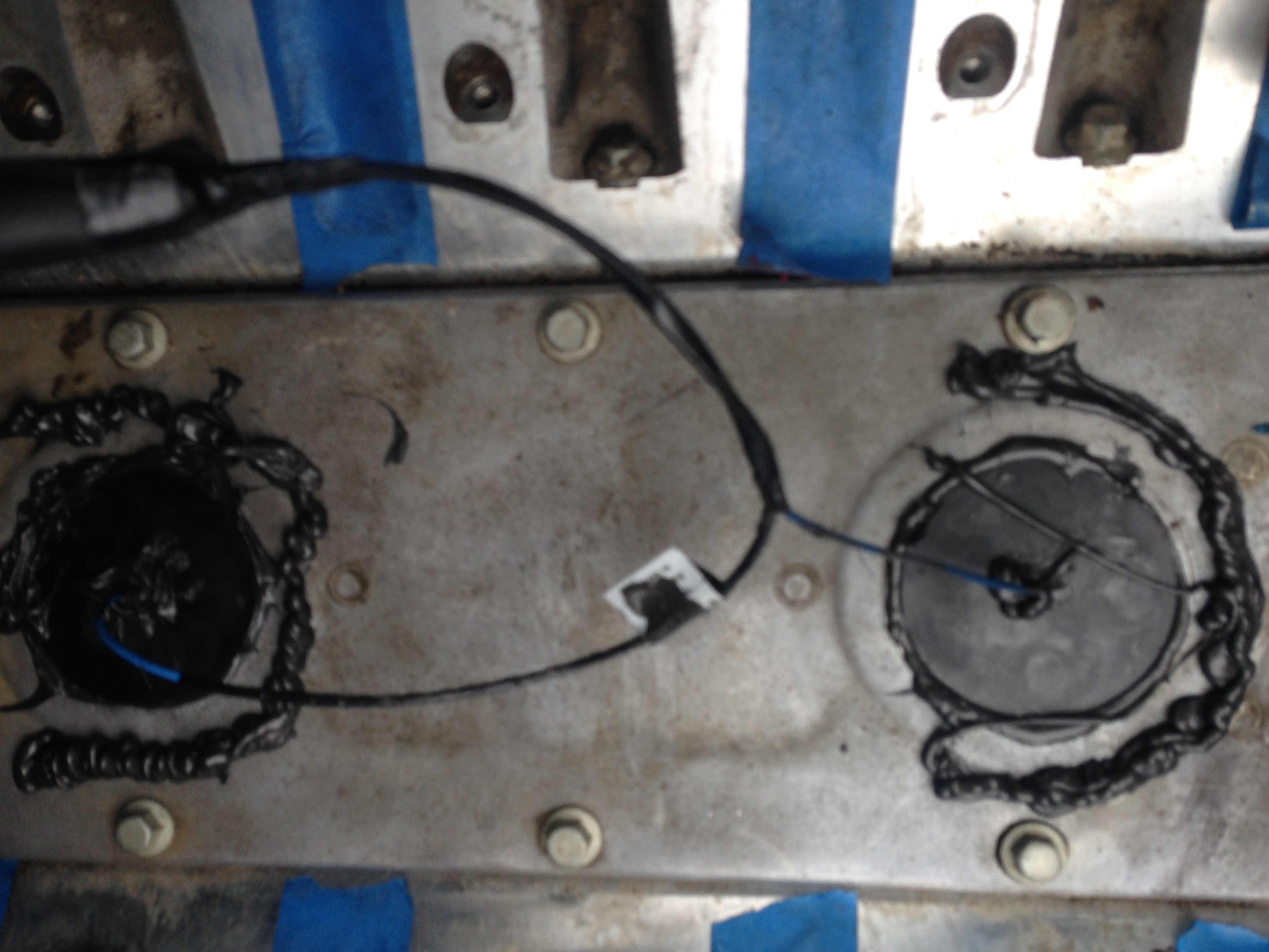

Yeah, reset the code but as soon as the sensor trips the truck has no power. I had to change mine a couple of years ago. Not to bad of a job if you're good at one arm push-ups... Haha. Pm me if you have any questions

OK knocking was from one broken and one loose exhaust manifold bolt. I managed to tighten the loose one and the knock is gone. Truck is now also throwing random miss and mass air flow sensor codes.
