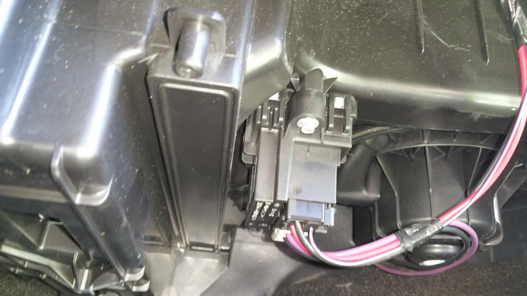

The filter "location" & design is different on my 09. I feel this should at least reflect the 2008. I can't confirm if the 2005-2007 share the same design.
As you can see. it's a straight slot. It looks like a lot of GM trucks from 2003-2007 used this design & the dual filter, L shaped slot/cover is an older design (2002 & earlier). As for all of the H2 owners here, there are a few fixes.

The benefit of the thread I found is that it linked 2 compatible filters:
Fram CAF18121C
Wix CF10360

I might be ordering the carbon activated filter soon. The filter size forces you to buy a special filter like these that bend so you can force it up into place. Considering the clearance (or lack there of), this makes sense.
