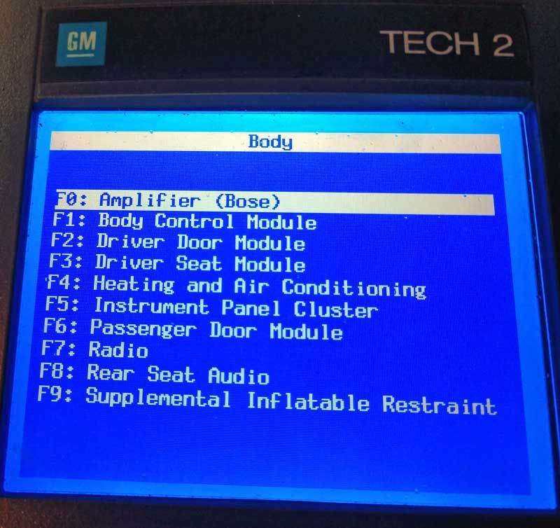

Old Oct 18, 2019 | 02:41 PM
Its not just the GMOS and the Bose. That is something you have to balance on any system with an external amplifier. Typically you are adjusting the gain on the amp itself. In this scenario you are adjusting the gain on the low level signal to the amp which has the same affect. Crank the gain up on an amp and you gain volume at the expense of clarity, distortion, and audible hissing.
One thing I have not experimented with though. Using a Tech2 I know I have seen the volume level of the Bose amp. I need to see if that changes when using the volume on my Kenwood (also through a GMOS) or if the Bose is basically at the level it is at and our volume is solely based on the level of the input we feed it. If the Bose volume does not show as changing on the Tech2 there is a remote possibility that the Bose amp could simply be stuck forever at whatever the volume was set at when the stock head unit was disconnected. Seems unlikely though, but if that is the case it might be possible to temporarily plug the stock head unit back in, power up, crank the volume to the max, kill the power then reconnect the aftermarket unit. If that is the case it would also make finding the perfect balance even more complicated as you then need to adjust for the Bose amps level, the GMOS level, and the head units level. lol
Old Oct 19, 2019 | 01:52 PM
oceanbrave's Avatar
Joined: Feb 2015
Posts: 1,635
From: Birmingham (UK)
Looked for the BOSE volume level but could only find "Rear Seat Audio" controls which read only. As I have no stock radio or navigation units installed I couldn't access those options.
It's an intereseting point regarding the BOSE levels, one can only assume that the default is max volume. I've read many threads on HU installation but no one has mentioned it to the best of my knowledge.
Old Oct 19, 2019 | 03:22 PM
I just checked on mine too! Different results though. I do have a rear seat audio and as you said, nothing to really do there, particularly since I have any aftermarket head unit. But.... I also have a Bose Amplifier choice to look in.
Old Oct 19, 2019 | 03:35 PM
Looking in the Bose amplifier section there is nothing that can be adjusted. But the data display is intriguing...... I did try changing the volume on my Kenwood head unit but nothing changed and the volume stayed at the 78.8%.
So yes, now this has me even more curious. Unfortunately I'm not going to have time to pull her into the bay, pull the dash apart, etc to test any further anytime very soon. Things I'll be curious about are for one, would changing the level on the GMOS change the Bose amp volume? Second and regardless of the GMOS, would reconnecting the stock radio and changing the settings on that let me adjust the fader to zero, volume to max, etc then kill power and those settings be retained in the amplifier? My guess is they would as the stereo always starts up at the last volume level, something that has likely caught everyone off guard at some point. Like having the stereo blasting when you last shut it off and forgetting, start in the morning and jump out of your skin when it surprises you because it is suddenly blasting. lol On a side note, my Kenwood is good about that..... be listening quite loud, phone rings, and audio is automatically muted, have a nice long conversation, hang up not remembering it was blasting when the call came in.
Anyways so there it is. Mine is apparently stuck at 78.8%, fader is stuck at -7%, bass and treble reasonably well centered, chime volume... had no idea that was even adjustable. I seem to remember that was adjustable via the GMOS so another thing to test, does adjusting the chime level on the GMOS change it on the Bose amplifier? One I did not check was if I adjust the fader on the Kenwood does that -7% change on the Bose? Based on the volume not changing I suspect not. If setting these things on the factory head unit before disconnecting it does retain than that basically means a whole different level of tweaking settings is possible, albeit somewhat tedious and time consuming and of course would require still having a working stock head unit and a lot of plugging and unplugging. Of course you would also need a Tech2 to verify if any of the settings are retained as well for certain but it could be verified without by, for example, connect stock HU, turn volume to zero, disconnect and then connect aftermarket HU, test, and then repeat this at a few different levels.

Interesting, I have an entirely different display to yours, maybe my Tech2 software is different, older ? (also my truck is not CAN) I see your display has Function Keys whereas mine has a Scroll List, curious??
