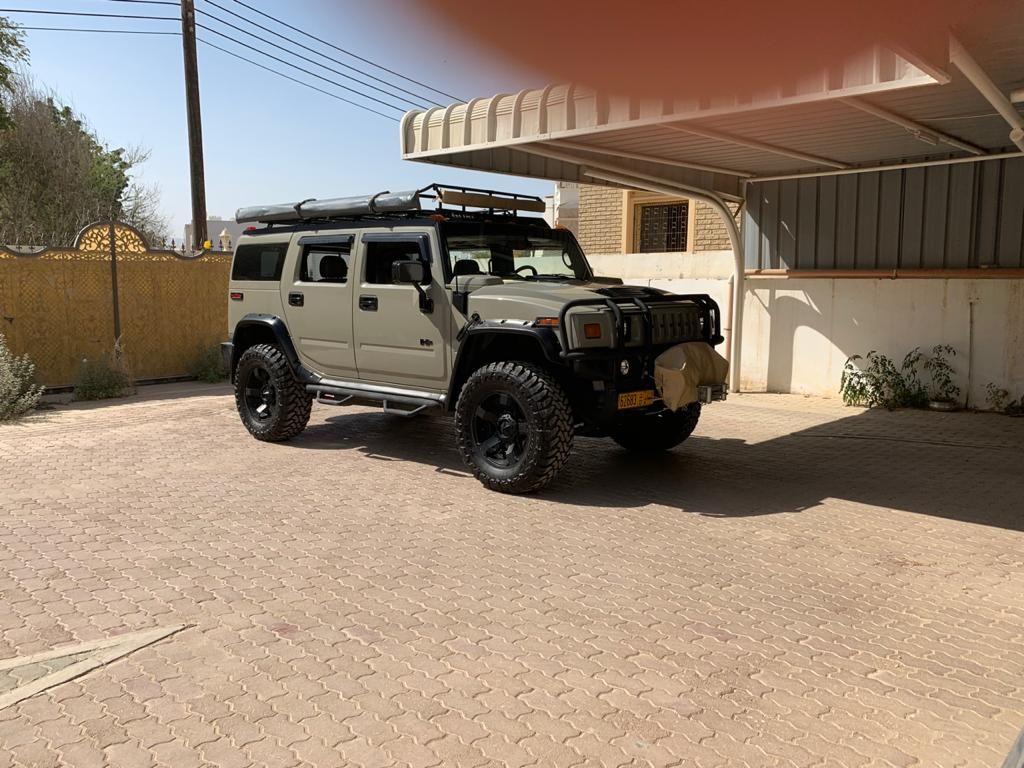

here's my H2 on 2" body lift to accommodate the 38" mt tires

did you have to do any lengthening of lines or anything

Posts: 46
none it's a straight forward install, you'll just need to be a bit creative on the front and rear bumper gaps. having said that, i wouldn't go beyond the 2" body lift.
