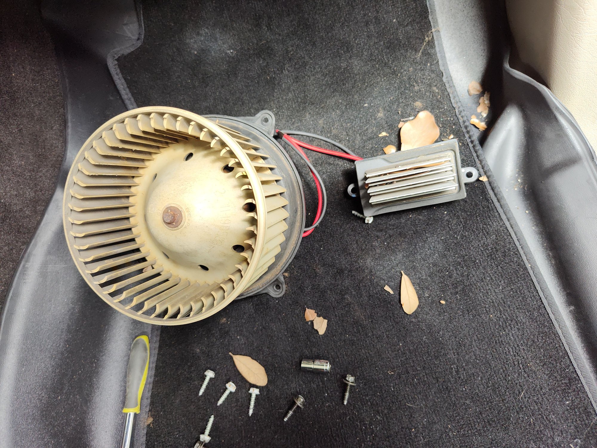

you can reach the evaporator to clean out the fins by removing the blower rmotor. mine somehow had leaves and debris in it when i had purchased my truck. i used a vacuum and foaming coil cleaner i purchased on amazon but home depot might also sell it. if you have moldy smell in there you can kill it with spray lysol.

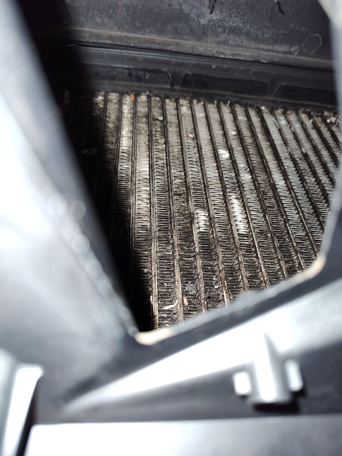

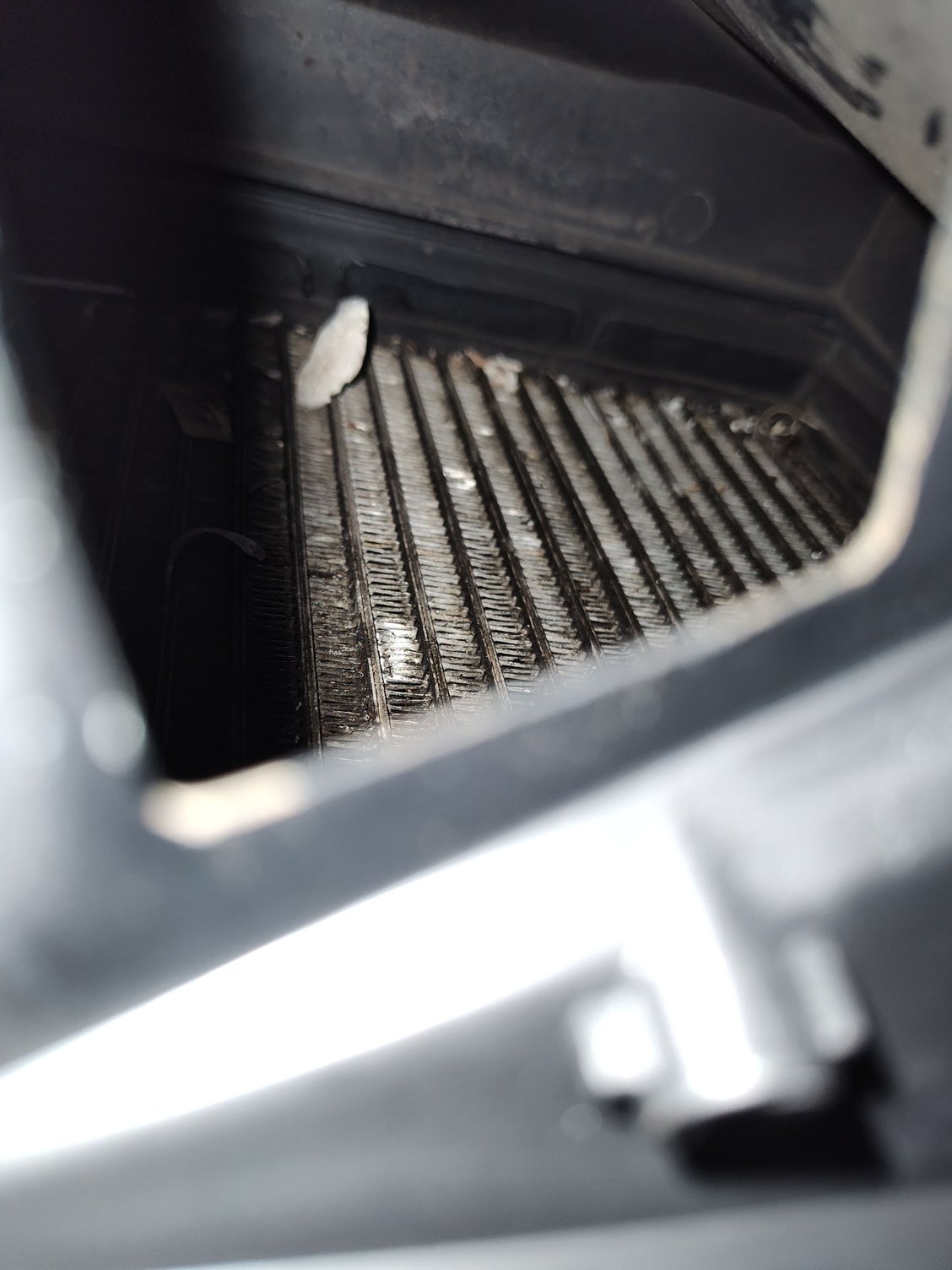

So I pulled the fan and couldn't see much with my phone, but could see evap when I pulled the fan control pack. Som leaves fell out with the fan and pack, and there were a few on the coils. But not many and it looks relatively clean for 23 years. I'll be foam cleaning it on Monday, but don't think the evap is clogged enough to keep system from cooling. Last pic is after small hose vacuum job.

you shoul check the drain while you have the blower off. the evap does look a bit grimy. you might need to agitate the cleaner with a brush. might also need a spray bottle with some water to flush it out. the air box drain should let the water out and keep it from dripping inside the cabin. well as long as it is not restricted / clogged.
