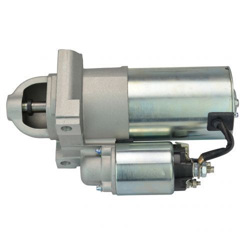

I took the old starter off because it's rusted to hell and I'm pretty sure it's the problem. With the worst luck imaginable when I was taking one of the nuts off it fell and I can't find it anywhere. I even checked the ground all over with a magnet. The only thing I can think of happening is that it fell inside here (attached photo). Will it cause catastrophic damage if I start the truck with a nut inside there ? Is that the flywheel? I did order a boroscope and I'm going to try to look inside there to see if I can see the nut.

Just to be clear, you took the nuts off after you unbolted the starter? Btw, that's the tc and flywheel. You can use a socket on the crankshaft to turn those, or get a flexible stick magnet to find your nut.
Yeah i unbolted the starter first because the wiring attached on top was too difficult to get to until I had it loose. Then in the process of taking the nut off to disconnect the battery from it, it dropped somewhere and I've searched and searched and cannot find it. I will try using a flexible magnet and boroscope to find the nut. If I can't find it but it really is in there, will it cause damage to run the truck ?

try looking from the top of the engine down maybe its on the motor mount or chassis /suspension or pinched. on the exhaust shields if you still have any

I've looked every where, even using a magnet and boroscope and cannot find the missing nut. I guess my main question is that if it did somehow get into the transfer case opening where the starter was removed, will it cause any damage if I run the truck with it in there? I love creating new problems before I even fix the original one!!!!!!!

well there is an inspection window on the bottom of the transmission you might have access to reach it. anything is possible having a loose part next to a rotating mass.
