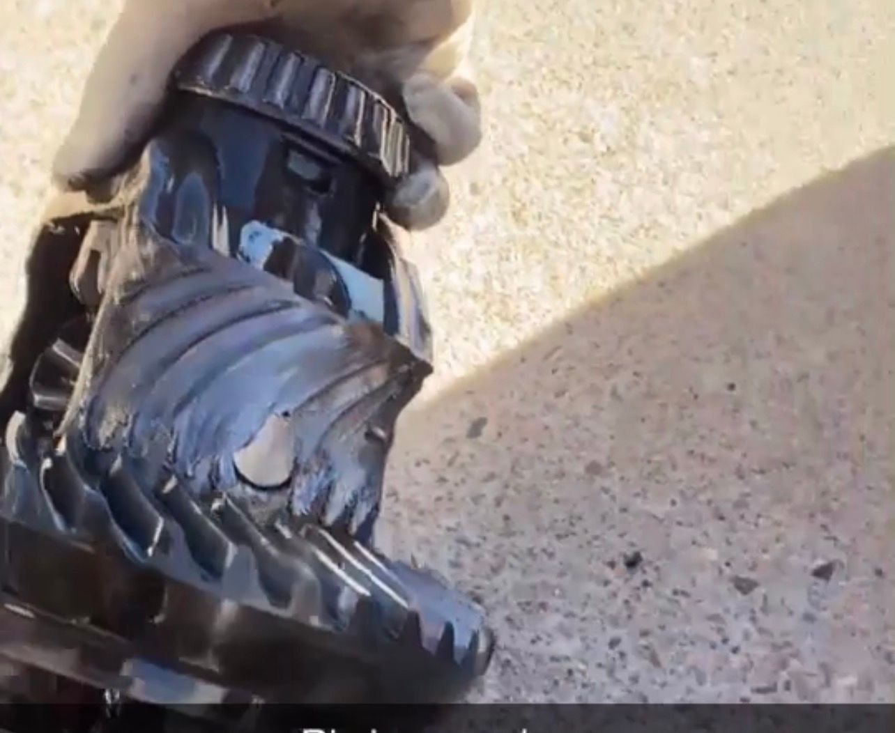

Well I’ve been trying to figure out this problem with my hummer.
The rig drives perfect straight and reverse. Only when I I’m turning it feeling like I have a dragging rear differential the turning radius is god awful.
03 hummer adventure
240k
Kryptonite front suspension
heads
cam
long tube headers
rebuilt transmission
new cv axles
this happened before the front suspension upgrade due to the planetary gear failing on me. Now I haven’t driven the hummer in about six months because I don’t want this to happen again because it does feel like it’s pushing against each other when I turn. again, the turning radius is really really bad but when I go in reverse or forward, the truck doesn’t work. It’s only when I turn. Any help please I wanna drive my truck again
