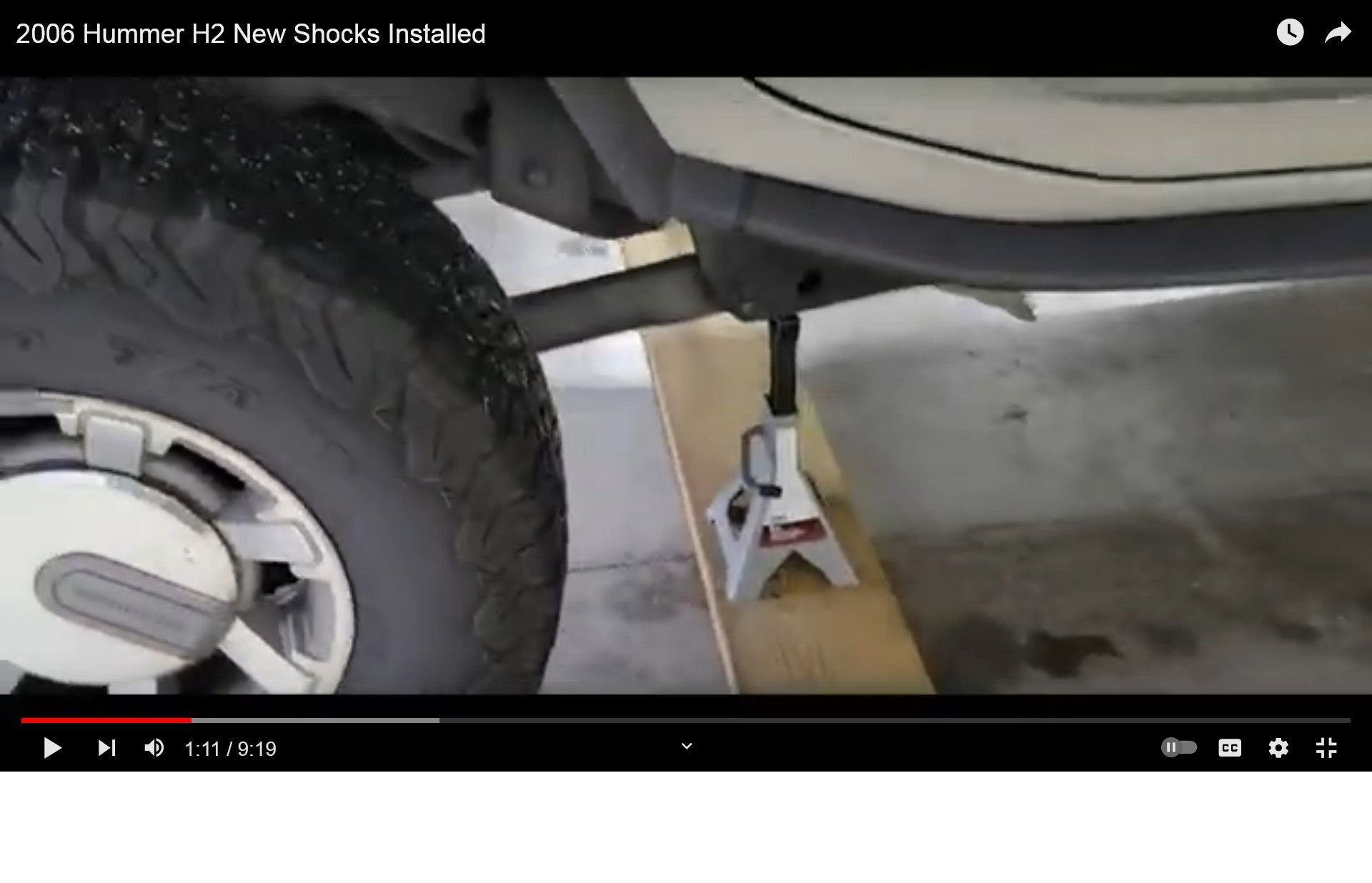

I have jacked one side of front w/ piece of wood under the A arm can’t remember where I placed the stand (same 17” stand). I think here.

You need 4(I use 3ton)jack stands to properly support and a floor jack to lift front and rear. Simply lift the front and rear at the center of the diffs and set the jack stands under the axle extension tubes to the wheels, or frame or control arms on the front. After all wheels off the ground with the jack stands holding the truck, walk around pushing/pulling on all 4 corners to make sure all secured without falling. BTW, ONLY JACK & STAND ON LEVEL GROUND!
Here's an amateur video showing rear jack&stand lift:
