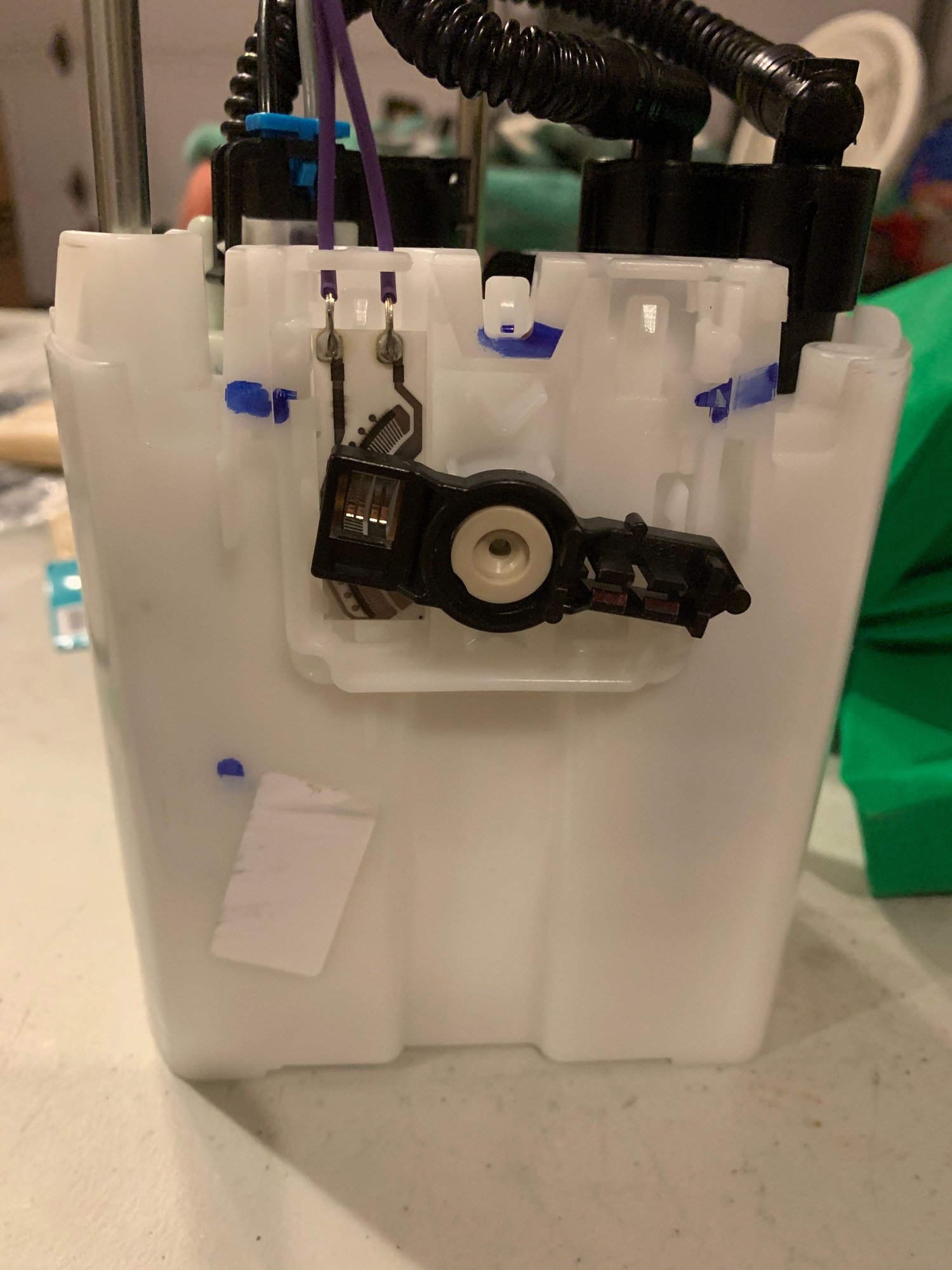

I got my Delphi pump from RockAuto today. I know Oceanbrave got a few defects. Do you mind taking a look and if it has the same issue you had? I can't see anything wrong with it

As far as I can tell your's is the correct Delphi pump and the little "lugs" that got broken-off on mine look to be intact - so it all looks good to me.
I've marked-up your picture with lugs 1,2,3 & 4 it seems yours are OK
Regarding the brake lines I've replied to your PM on this.
It might well be easier with the fuel tank removed, can't be any harder.
