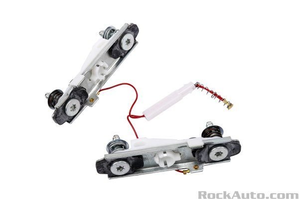

Thanks hummerz great tips and support as always.
The video's were helpful, plus removing the steering wheel airbag module was super easy.
Bottom line was the slip-ring sping-loaded "Horn Contact" was coated with some kind of contamination or corrosion, which was easy to clean, so all's good now!
For reference RA stocks the part, GM 16821883 for $11.00 which looks like below:-
Not that I needed it
