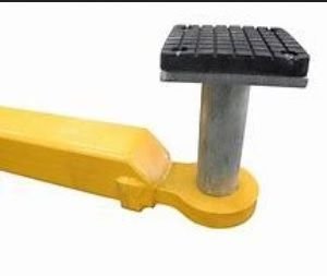

Video to show you "lift points", with 4 lift padsholding the H2 body in the air without causing damage.
You only need to lift a bit to pull/replace bushings. Bolts out first, lift just enough to pull/replace bushings.
1 side at a time remove all bolts on the side you're working on, lift at a proper lift point and pull/insert bushing and install new bolt to hold new bushing in place> left loose. After all bushings/bolts are installed on the side you're working on, drop down on level ground and tighten/torque all bolts.

Looks like they found the front jack point and a rear jack point at the far corners of where the rockers begin and end.
So there must be a strengthened point there which is hopefully accessible. I will search for those spots.

@hummerz OK, so I just crawled under the truck. Those 4 lifting points shown in the video are not available on my truck.
There are 3 things in the way, which would involve so much dismantling of the truck, that it is not practical solution.
1. The frame-mounted rock rails - 2 person job to re/re, and PITA.
2. plastic OEM rocker panel cladding (covers on the special edition). Warped from age, likely brittle, don't want to remove them.
3. Plastic body-color fender flares (overlapping the plastic rocker panel cladding at at least those spots). Ditto for removal concerns.
