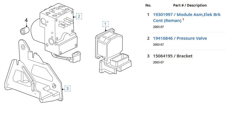

So this is under the drivers side just near the torsion bar key. I think maybe a brake porportioner or transfer case controller? The main problem is it is just hanging there by some of the lines with no mount or bracket and is heavy. Can anyone I'd and let me know how it is supposed to be mounted? Thanks
Old Apr 7, 2020 | 12:08 AM
Posts: 3,217
it is your abs pump for your brakes. the lines holding it are your brake lines. you don't want it floating around. very dangerous.

Posts: 35
Hows it supposed to be mounted? A bracket?
Old Apr 7, 2020 | 01:05 PM
Posts: 9,046
available here ---->15064195

Posts: 35
This part isn't in stock anywhere. Anybody have a lead on one ? used is fine, I dont want to not secure this correctly
