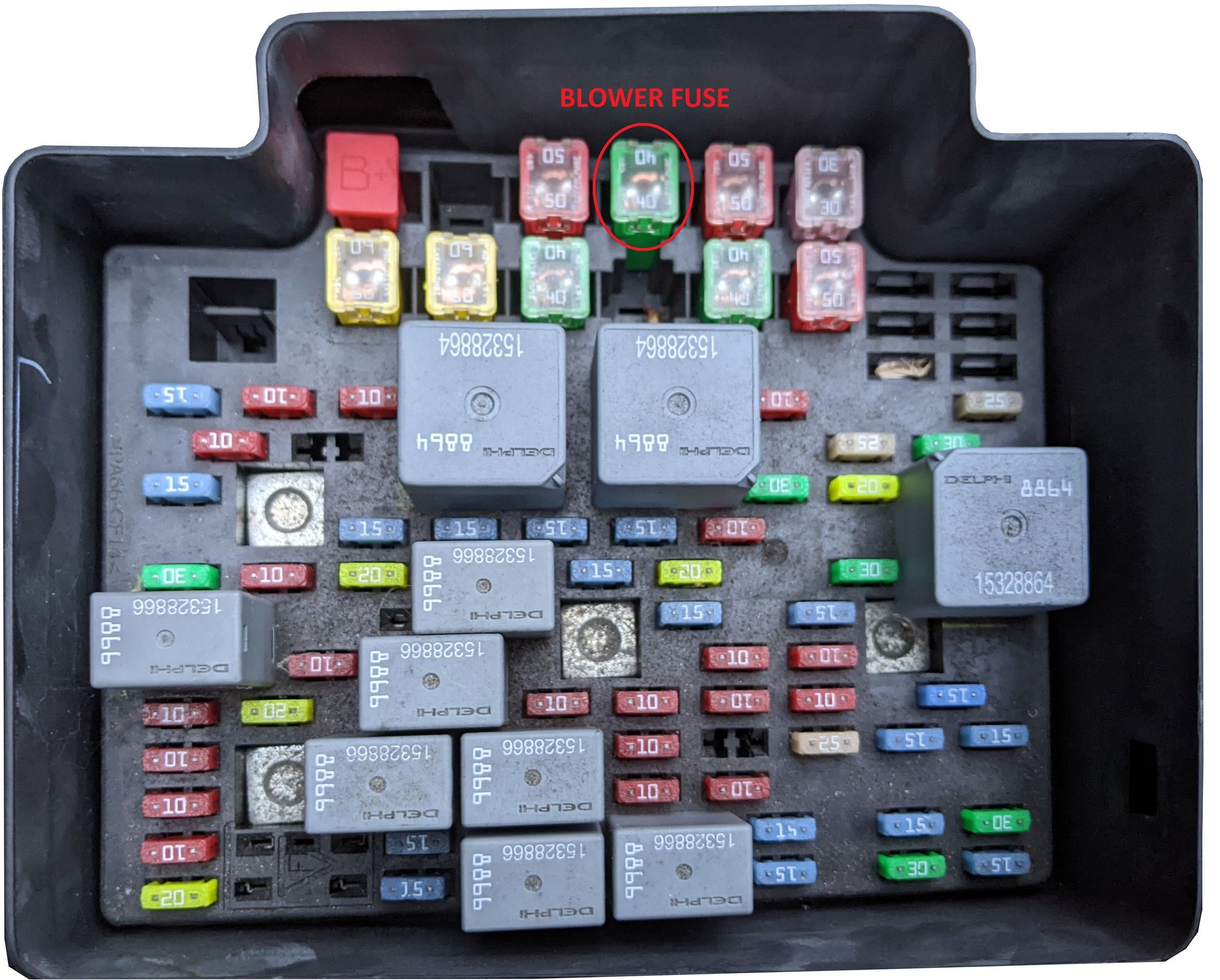

I have a 06 H2,I’ve replaced blower motor fan and blower resistor and my fan still stays on after I turn vehicle off,which fuse is for the hvac system and where is it located

You have a problem with the replacement blower module I suspect.
Might be easier to unplug the blower motor, however the fuse is the green 40A under the hood
