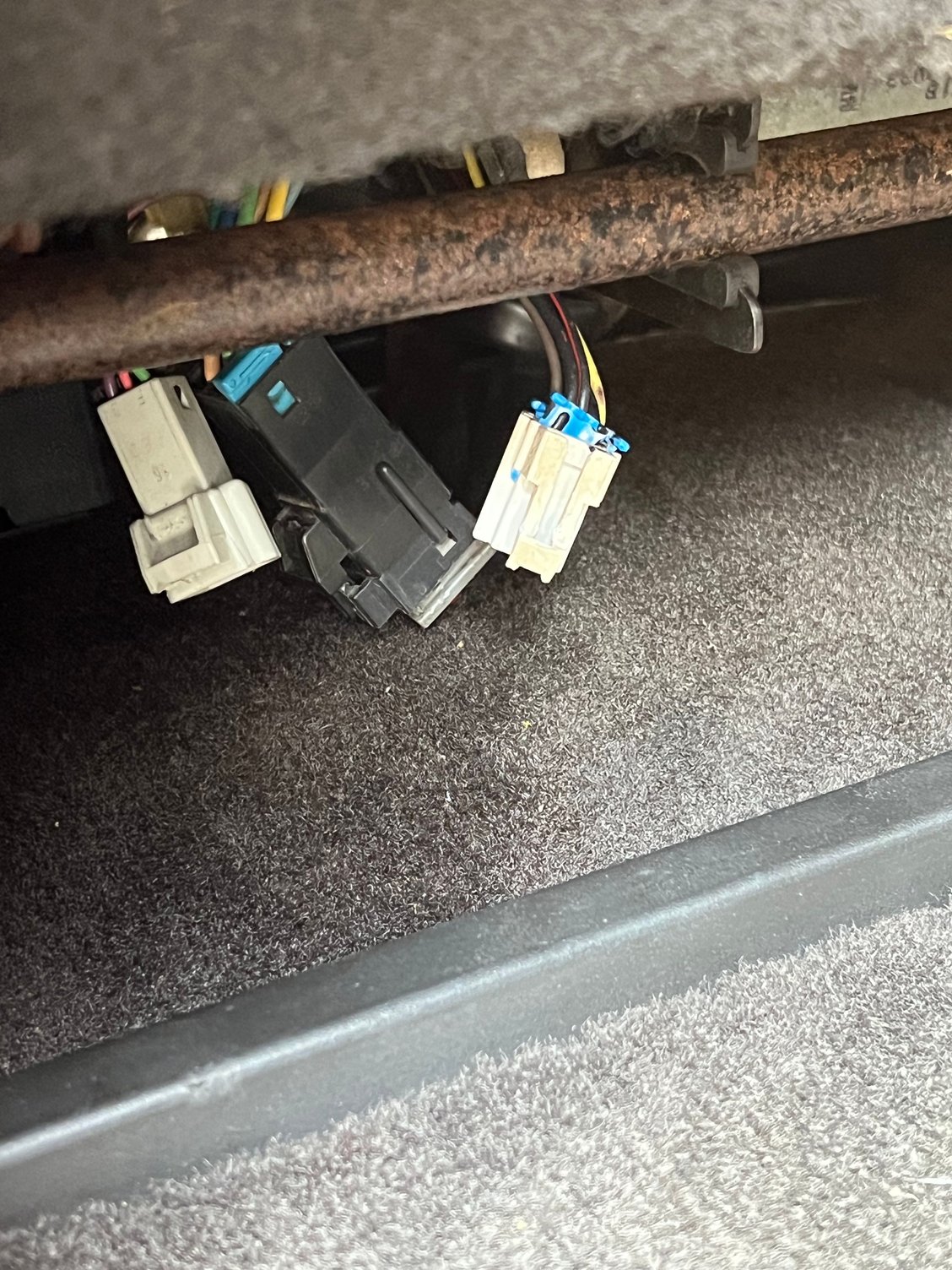

Fonzie Did you have any luck figuring this out? The same thing is happening to mine and you are right it is way too hot for heat seats right now.

U bet!!!! I never found a fuse for them. I reached underneath the seat, and I disconnected the wiring harness to the heated seat. It stopped it from coming on. If you need me to, I can take a picture of the harness tomorrow and post it. I am so very happy it’s not coming on anymore. It was to the point where is coming on every 10 seconds after I turned it off. It was strange for mine because in the winter time I would turn the heated seat on and it would click itself off, but in the warmer weather, it wants to stay on all the time.

That would be awesome if you could take a picture of which one to unplug I look under the front of my seat and I see 2. 1 with some larger wires that I am assuming would be the seat heat because of the amount of current flowing through them and then 1 to the right when you're looking at the front of the seat with smaller wires so if you could let me know which 1 to unplug that would be great

Sure of course. Here you go.
