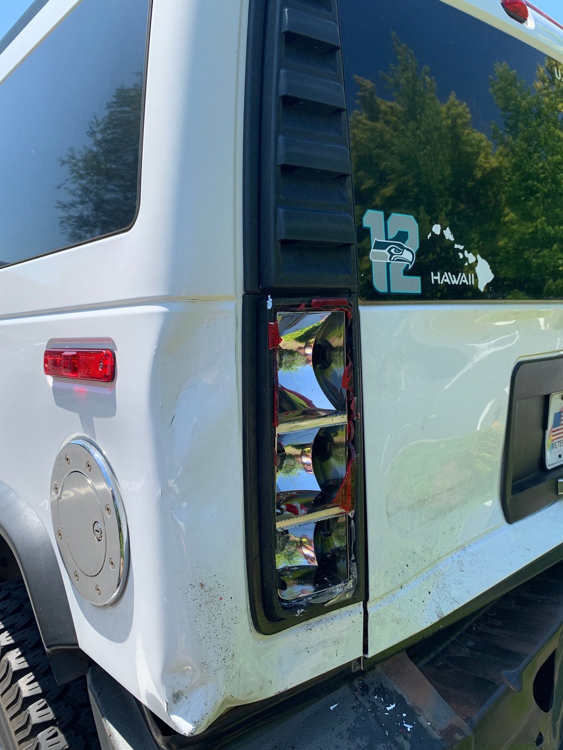

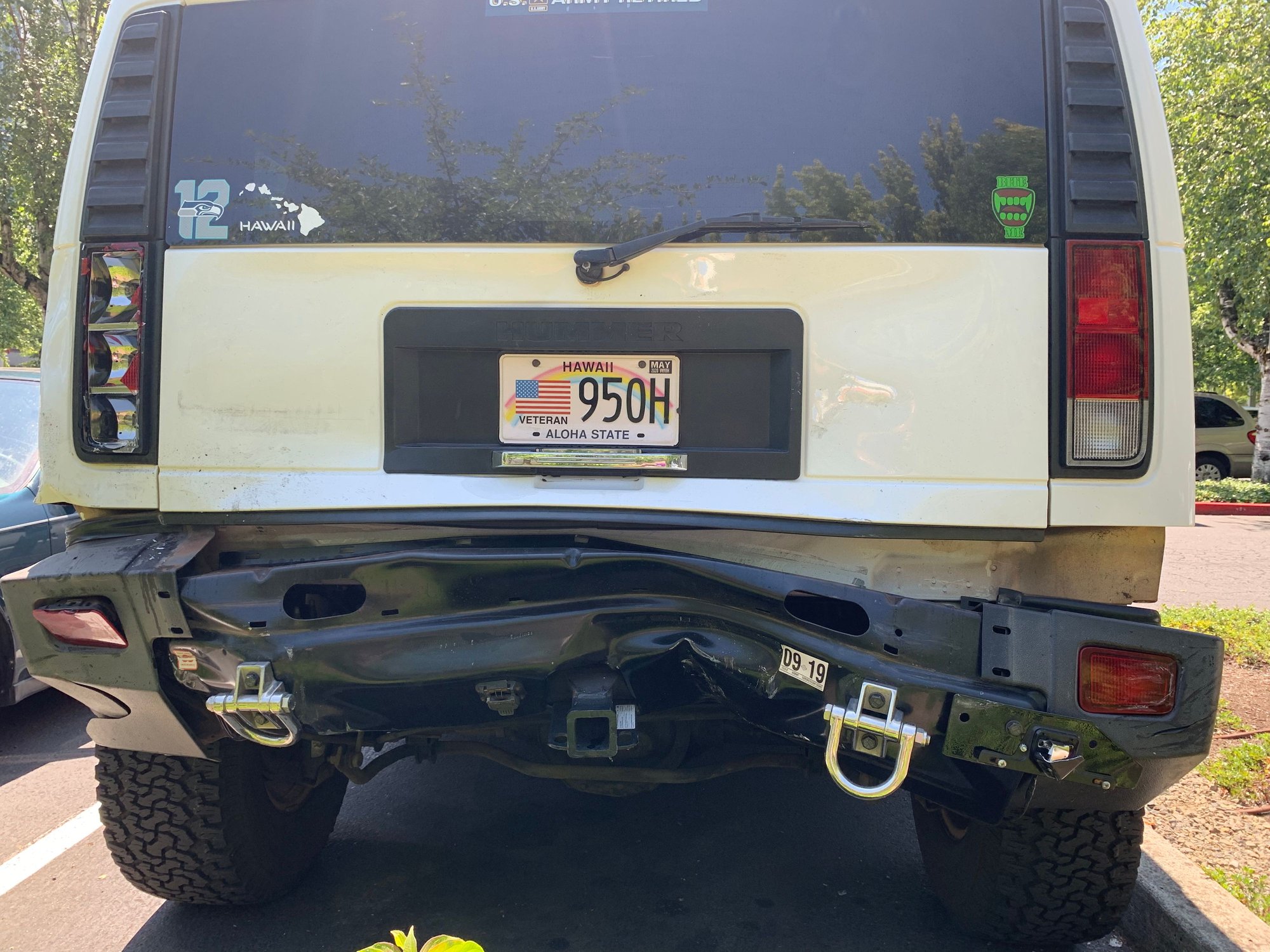

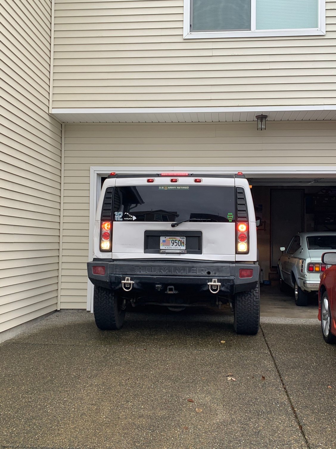

Here’s some pictures before and after. The last picture is with the used rear bumper and tow receiver. My 2006 H2 has only 40K miles 🤙

That looks like a pretty hard hit, did it total the other car?
Old Jun 30, 2021 | 08:37 AM
kauaiboy's Avatar
Joined: Aug 2019
Posts: 11
From: dupont, wa
Yes...it was a 1999 Dodge Ram 1500. I tooked out my spare tire carrier coz I like the clean look. Maybe if I had it on my rear damage will just be minimal.

The 03 liftgate replacement I'm planning to buy doesn't come with the license plate pocket so I'm thinking of using the one from my 06 without lights. I will just put back my spare tire carrier again.
