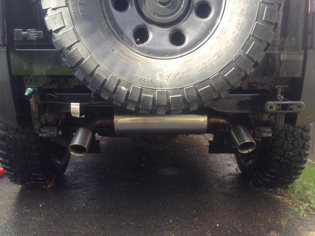

I do
Attached Thumbnails Got dual rear tow shackles?-bumper2.jpg   Got dual rear tow shackles?-bumper5.jpg   Got dual rear tow shackles?-bumper6.jpg

Where did the plate go? And do you really think the way you mounted it will be as strong as the right side factory one? I've never seen what is behind the shackle on the right side I don't know if it's just bolted into the bumper or there is an additional support structure behind it or what.

I'll get some pics up... I got a passenger side bumper bracket and modded the bumper...

So there's the how to get to the dual shackles...
Took some pieces of the frame rail
Attached Thumbnails Got dual rear tow shackles?-bumper12.jpg   Got dual rear tow shackles?-bumper11.jpg   Got dual rear tow shackles?-bumper7.jpg   Got dual rear tow shackles?-bumper1.jpg

the whole bracket is bolted into the frame rail in 3 spots, the bumper an additional 5, however to get it to work i cut off the smallest mounting tab on the bottom, I had to drill new holes for the D ring bracket and for the adjustment in the top bolts
