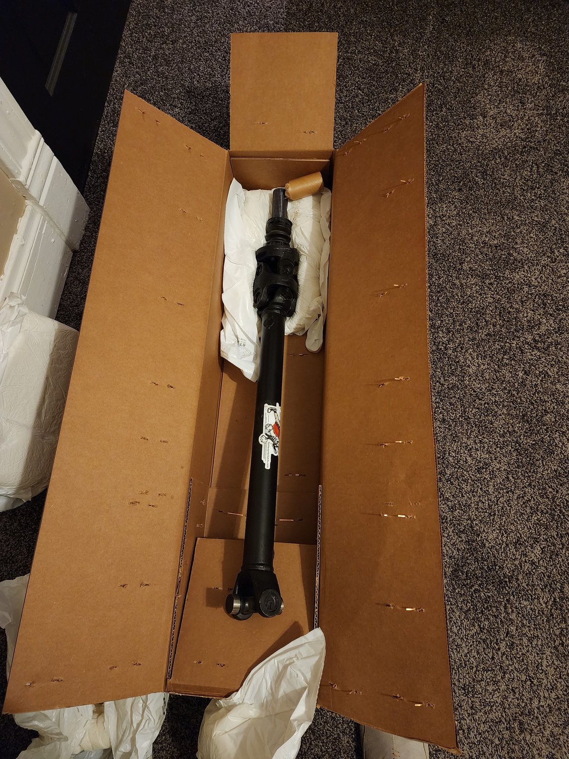

FYI - Ft Wayne Clutch and Driveline has a good product, great customer service, and an excellent price. Fabtech Lifts wanted $1100 for a replacement front driveshaft. Ft. Wayne Clutch and Driveline made one custom for me based on my measurements for $685. I will be installing it in the coming days and update this post with my findings and opinion. Steve over there was courteous, knowledgeable and helpful, so I expect the product will be up to snuff.

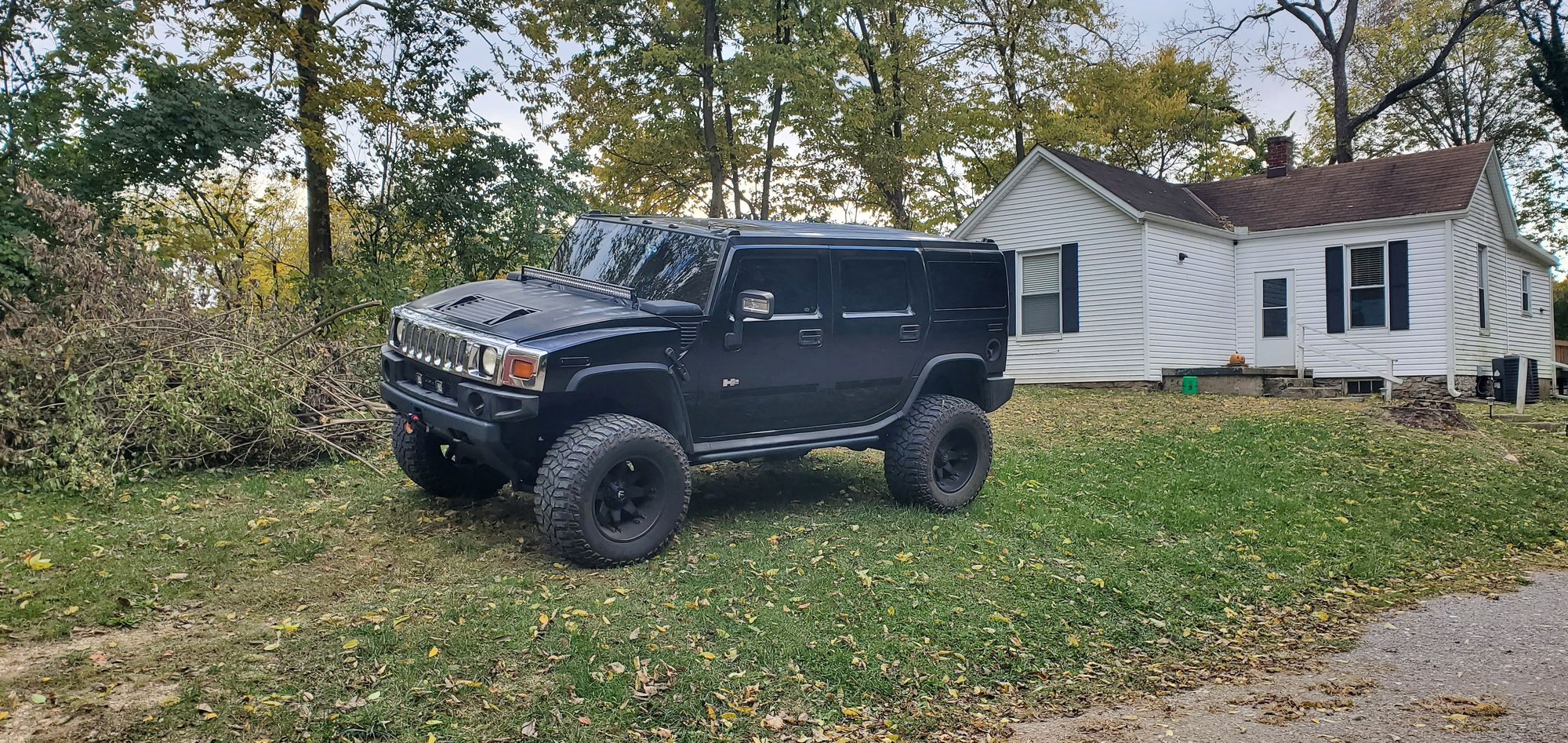

My H2 is lifted 6 inches on a fabtech lift, but they also offer stock/oem replacements at Ft. Wayne Clutch and Driveline.

The new driveshaft fit well. All works as it should, and is a better shaft than Fabtech offers. It uses a shorter output shaft which puts the double cardan joint closer to the transfer case for improved driveline angle.
