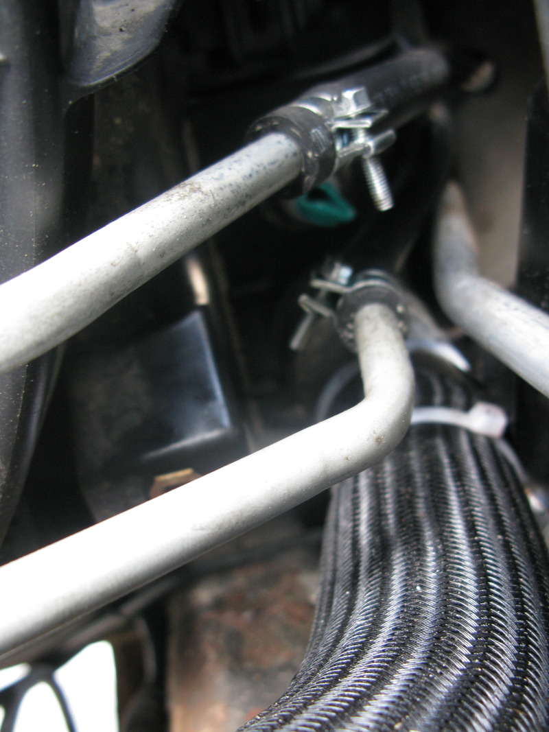

Old Jun 23, 2018 | 08:10 PM
NoSpoon's Avatar
Joined: Dec 2014
Posts: 114
From: Coastal Virginia
I just did this install today, I cut one line just under the new cooler, about the midline of the truck. The other line I used an included fitting so I didn't have to cut that hard line.
I went for a test drive, it was about 90 deg. F out and the temp got up to about 125-130 max.
Citiboy or anyone else with this mod have any problems with the transmission temps being too low? I don't want to make a mistake by over cooling the transmission.

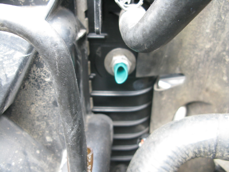

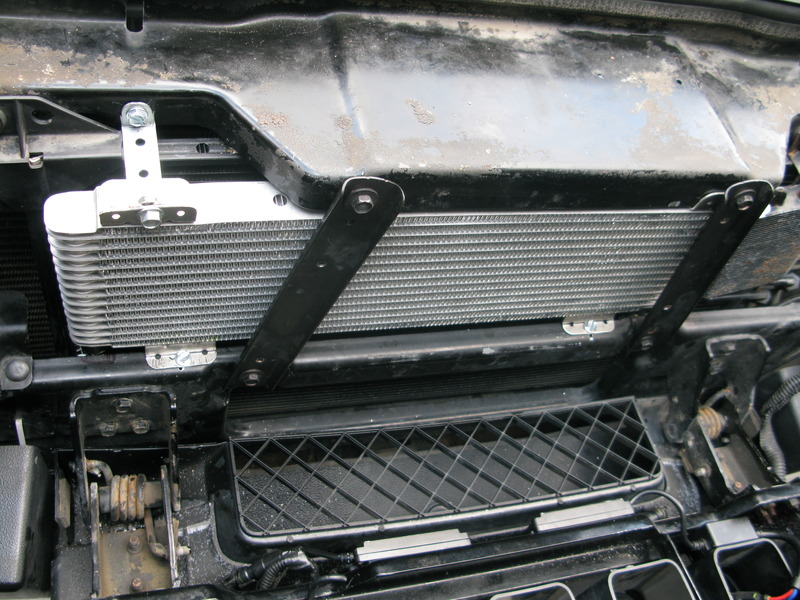

Originally Posted by citiboy
Just installed the H2 external transmission cooler and completely by-passed the radiator internal cooler. Now i don't have to worry about the coolant mixing with transmission fluids when the radiator internal cooler go.
I used this Amazon.com: Tru-Cool Max LPD47391 47391 Low Pressure Drop Transmission Oil Cooler: Automotive
Also, did this:
replaced transmission filter, transmission pan and gasket (old pan we're dented from off-roading)
completely flushed the transmission fluids with oem dexron 6 and reset transmission fluid life to 100% with Tech 2
replaced transfer case fluids with oem dexron 6
replaced front and rear differential fluids with oem 75w90 synthetic gear oil
replaced rear brake pads and parking brake shoes
Serviced front brakes
Need right rear parking brake cable, siezed, parts on order.
Road test result with the new external cooler (about 20 km distance), will update for long term use:
54*C at idle with 90*C engine temp.
65*C at 110 km/hr with 28*C outside temp
I used to run around 98*C with the stock tranny cooler.
I will see if i need to install the by-pass valve in the winter.
Attachment 11440
Attachment 11441
Attachment 11442
Attachment 11443
Attachment 11444
