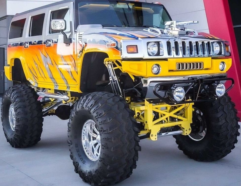

I have a 2007 H2 and purchased factory 08/09 20" wheels. I run 37 X 13.50 X 20 Nitto Terra Grappler G2's. They fit perfect and the only rubbing is very minor on the sway bar when turning tight.
Looking at that pic, I would pull out the tape measure and check tracking.
