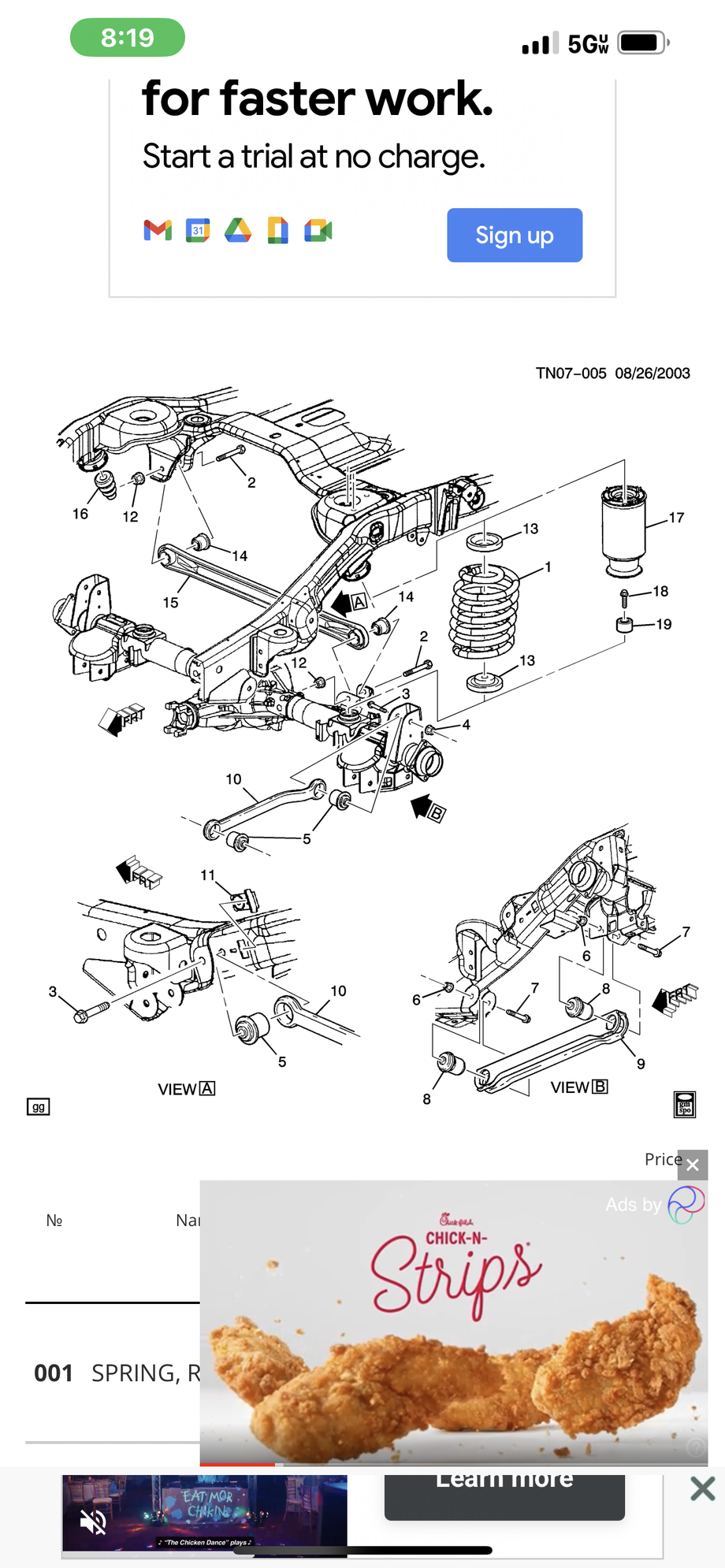

Do you happen to have the Black Rubber mounts that the bottom of the air bag sits on?[
QUOTE=H2-SUT;408292]I am getting ready to do a conversion from coil to rear air suspension. What I am looking for is either the rear pucks that the bottom of the air bags sit on top of. Maybe someone here has converted to coil springs and have these pucks and hardware just sitting around collecting

Does anyone happen to have the black rubber mounts that the bottom of the airbag sits on? It’s number 19 in the diagram.
