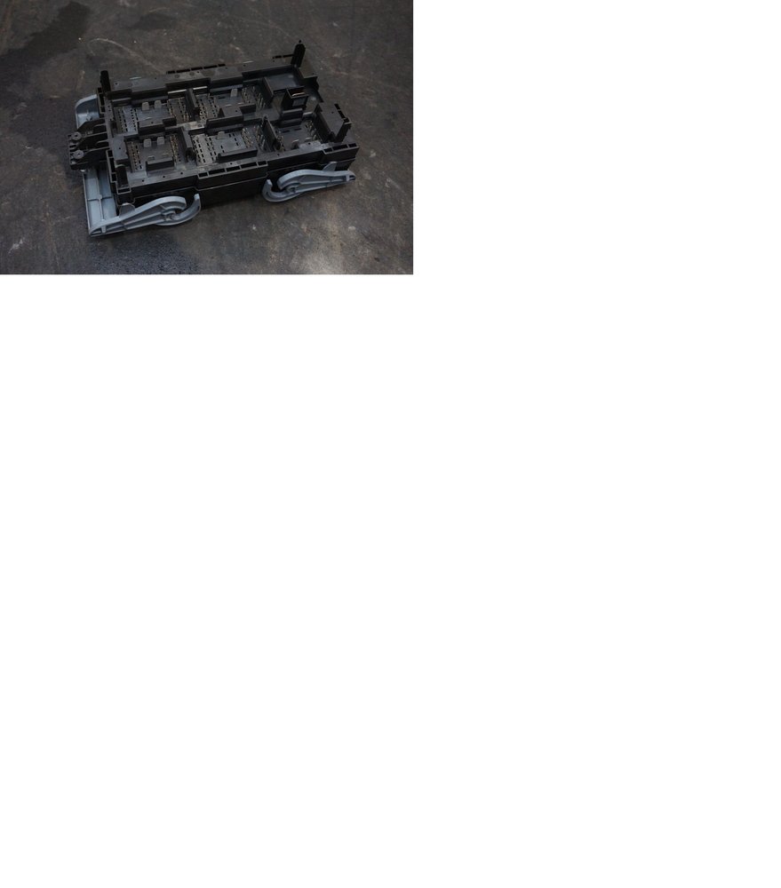

Update
Think its P/N GM 20806094 and the underside looks like below, probably take a bit of re-working or just replace (if available)
Old Nov 10, 2022 | 03:57 PM
Posts: 3,213
maybe relocate the relay to an empty relay provision on the fuse box. i had to do that for a dodge TIPM fuel pump relay was integrated to the board. benefit was now it had a normal externally serviceable relay.
Old Nov 10, 2022 | 04:04 PM
oceanbrave's Avatar
Joined: Feb 2015
Posts: 1,635
From: Birmingham (UK)
bronxteck indeed that's a good idea.
This 08 has modified headlights, so I'm wonder if they've over-loaded the contacts as some point, who knows.
