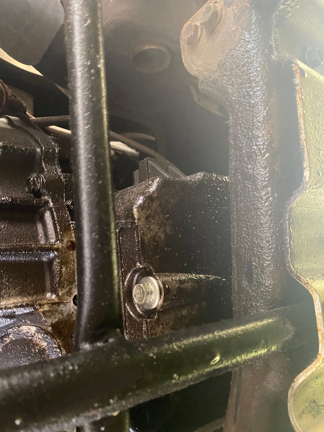

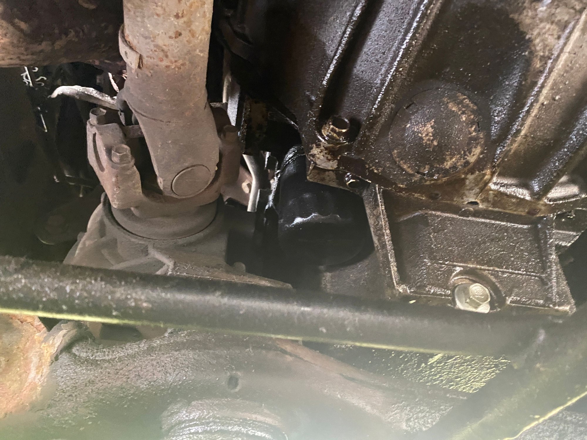

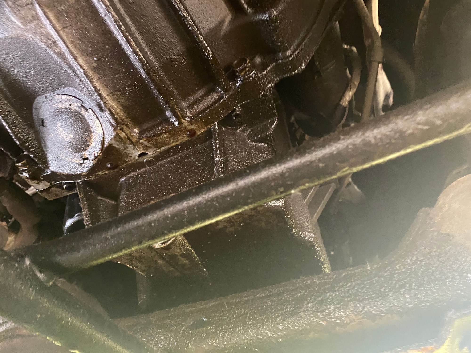

do these pics help?

best to clean up all that mess so you can determine where it is coming from.
but i second the oil pressure sensor theory it is a known leak point they separate internally and leak.
another known area to check it the plate that holds the oil cooler lines above the oil filter, in your pictures it is wet the gasket goes bad.
if you want to look inside the bell housing for oil coming from the main seal pop off the shiny but covered in oil metal circle cover on the bell housing in your picture.

Thanks for al the help! And sorry I’m a noob. I heard about the bell housing thing, is thst what it seems like in my pics or is it impossible to say? I heard if I pop the cover off and look inside and there’s oil everywhere inside there then it’s definitely rear main. Is that true? Can I just pop it off wirh a flat head screw driver??
my plan was to wash it underneath at a card wash really good and then look again. Is that the best way to get it clean underneath??

Looks like some valve cover leaks too. Check oil pressure sender, crank sensor and cam sensor. All will leak eventually. Also the oil cooler lines on driver side.
Tim
