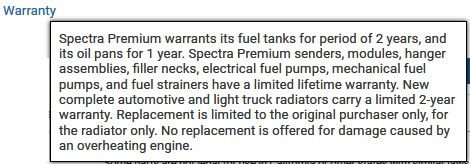

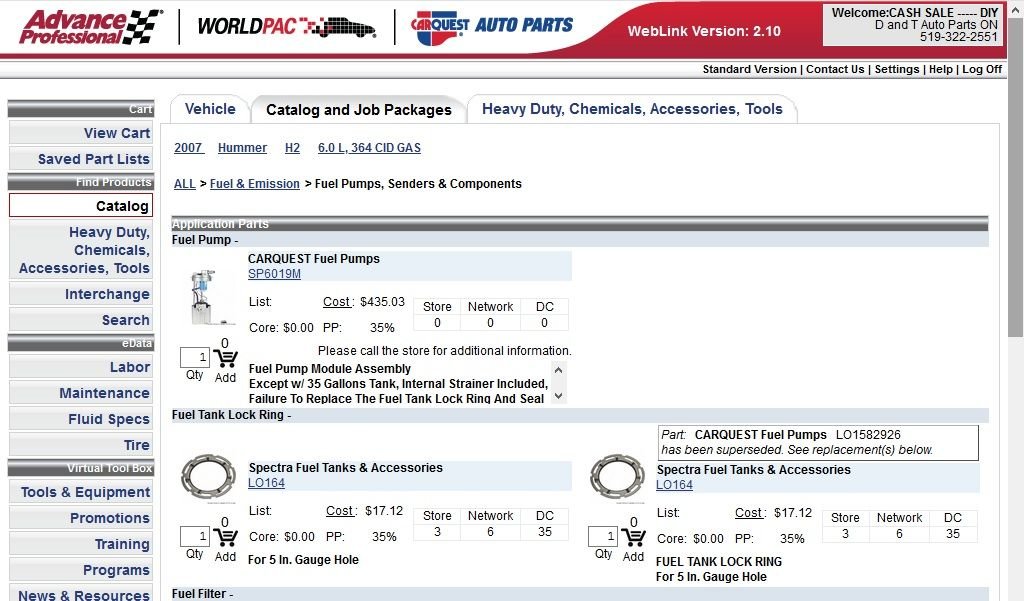

All the same, just different names on the box. Make sure to get a replacement lock ring too. Btw, Spectra is a Canadian manufacturer for ACD.
Also, Delphi is now manufactured in the UK.
Didn't know that...so I found Spectra locally in canada for the same price as the AC Delco at rockauto. Hope it's now missing anything because rockauto lists two ACD models. the spectra model is
SPECTRA PREMIUM INDUSTRIES - SP6019M
Would you go with that or for same price get the MU1423?

You live in Canada, and getting charged the same as ACD? Why so much? SP6019M

Yup, just checked. You need to find a friend down below you, that can send you a care package, aka "gift".
CAD exchange rate today: .74USD
