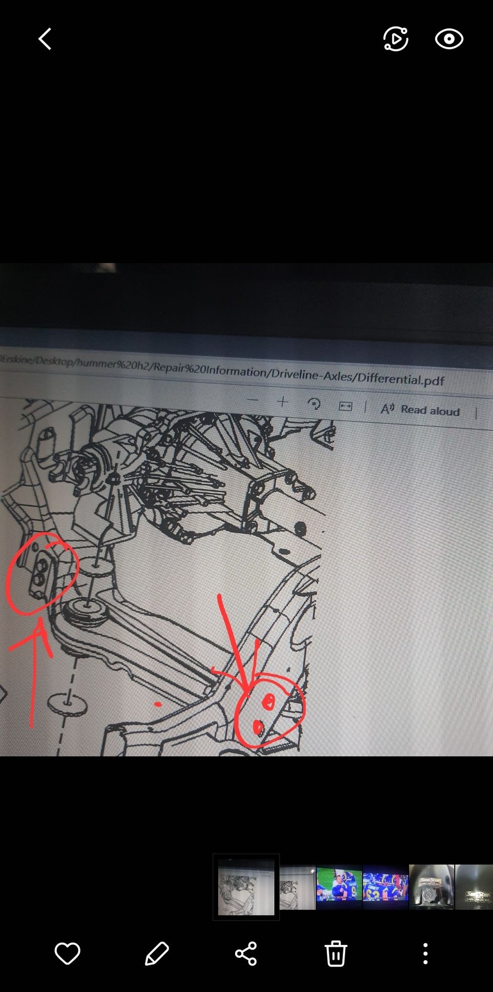

Maybe you can help im going to change oil pan gasket.
Question : In order to drop differential for clearance of removing the oil pan do all the Three Carrier assembly nuts and bolts holding the differential have to be fully removed.This means the three one is on lower left side of the lower arm crossmember bracket and other one is on the right side of the front axle and the third one is at top drivers side above differential.Thanks
Old Jan 27, 2022 | 09:27 AM
Never removed mine personally so no idea of there are shortcuts or if anything can be skipped but the GM service system shows what to do. See the attached PDF.
