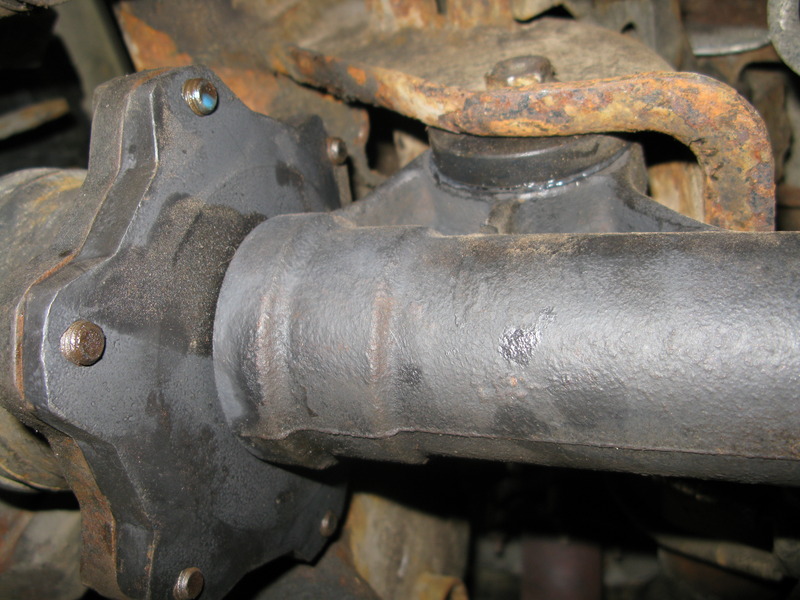

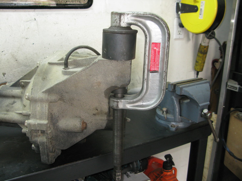

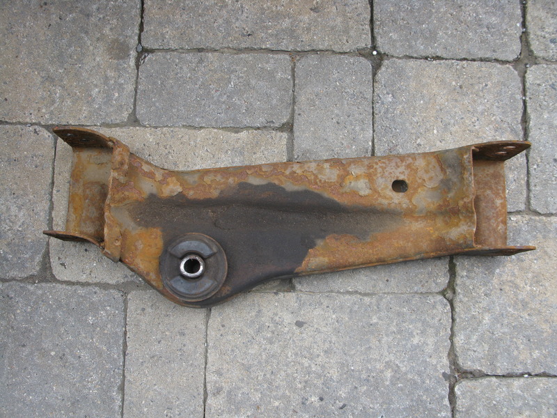

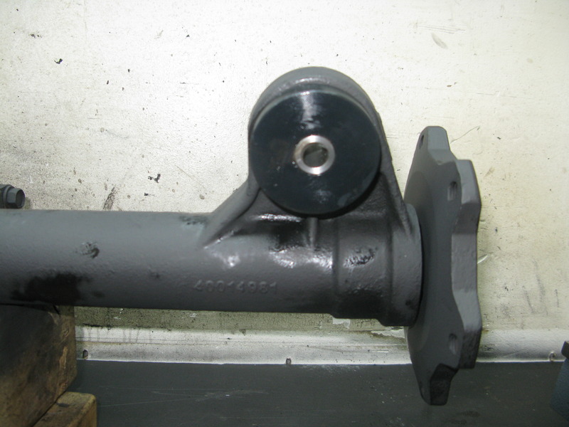

Upgraded my H2 front diff. and crossmember bushings from Outfitter Design. Also, replaced front diff. 2 outer seal with OEM and replaced 2 front u-joints with Spicer.

Great job. What did you do to the diff? Did you pick up any extra vibrations with the heavy duty bushings?

I didn't do any mods to the diff except replaced 2 outer seal that's leaking. No vibrations at all, it actually eliminates clunk. Will see if this hold up off-road.
