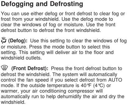

Also, looks like you are in Defrost Mode. .Don't think it will work in Defrost...
Old Jan 10, 2024 | 04:55 PM
Posts: 9,017

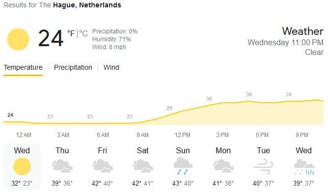

Yes, it is indeed very cold now, -5. So that would explain the flashing icon. But the light on the button itself must be on when I turn on the airco, right?
The problem is that the air conditioning does not turn on. So maybe the control panel is broken? The compressor has recently been replaced and refilled.

The light will not turn on when it’s too cold outside. The air conditioning won’t turn on because it will ice up quickly and won’t be able to thaw because it’s too cold.
is the blower working?
