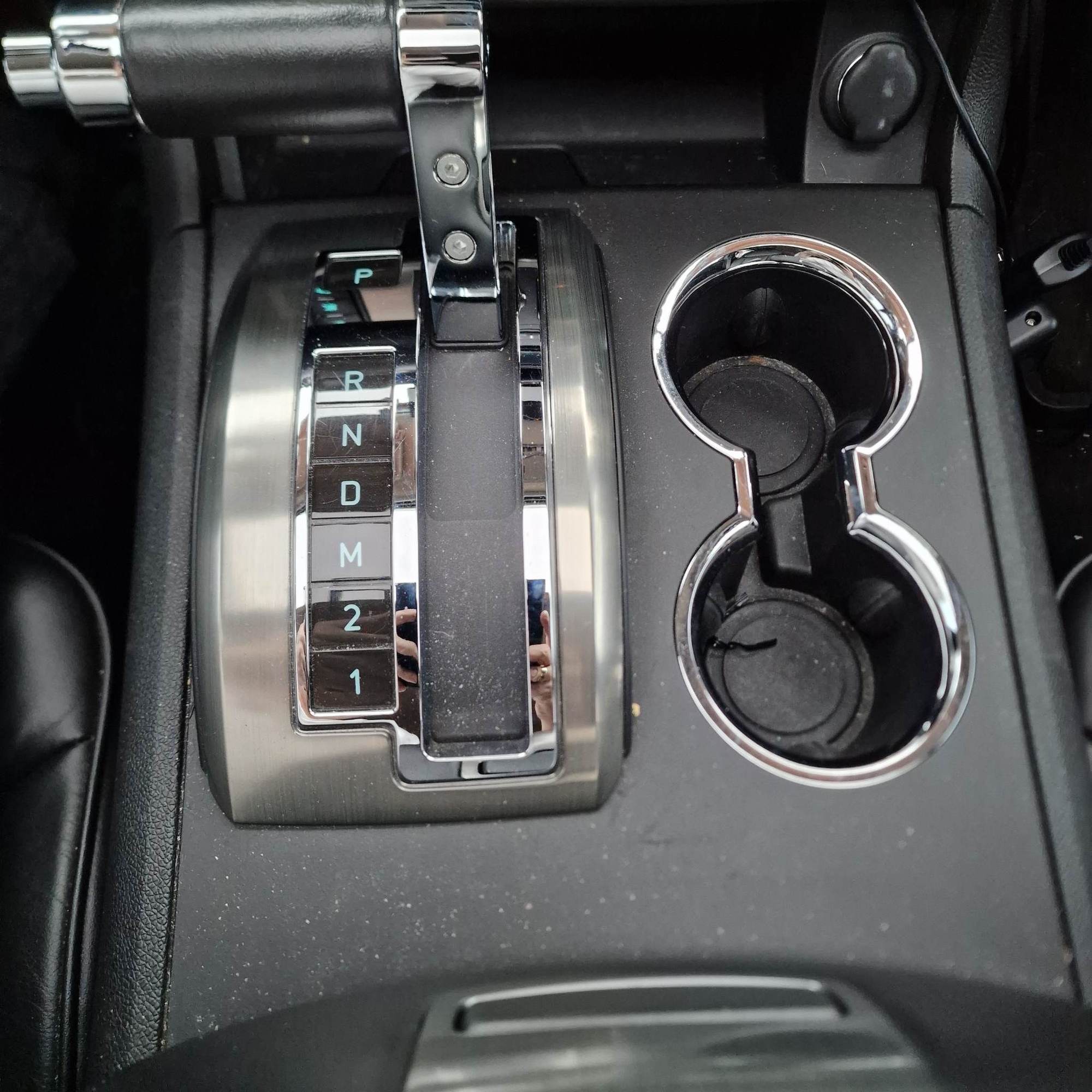

No dealers here in UK, so i've decided to just keep Halogen bulbs in flashers for now, changed every thing else to LED apart from the shifter lights, can seem to see how to remove the Shifter bit, managed to remove the handle bit any ideas chaps ? Please Photo of the bit i need to get under to change bulbs TIA Eamonn
