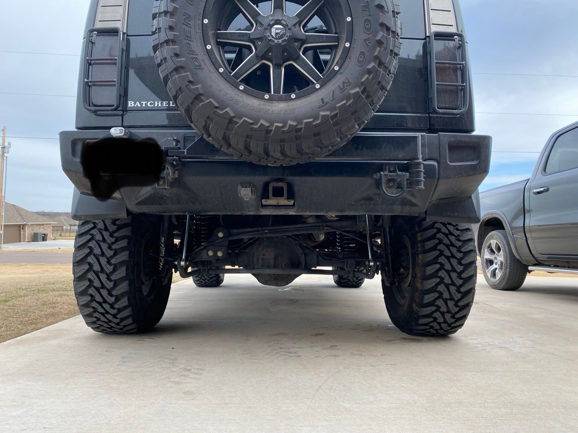

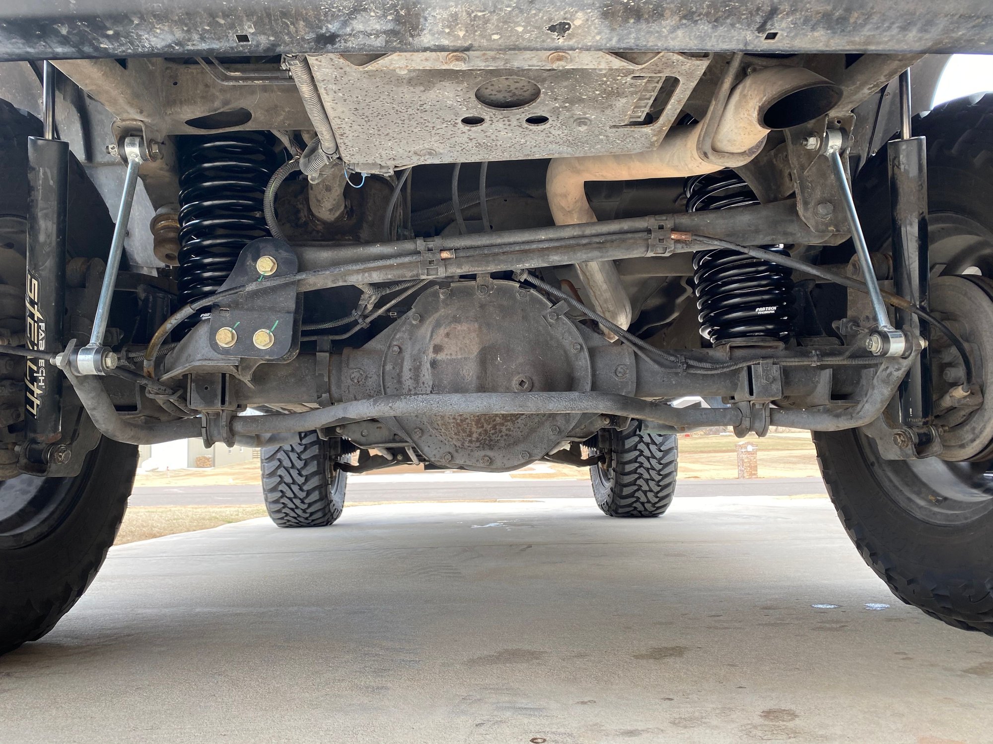

Just completed the FabTech 6” FTS27005BK coil spring conversion from OEM airbags. Vehicle lift, strut compressors & patience are the key ingredients. Overall took approximately 2 hours and that was with rotating the tires. Let me know if you have any questions.
