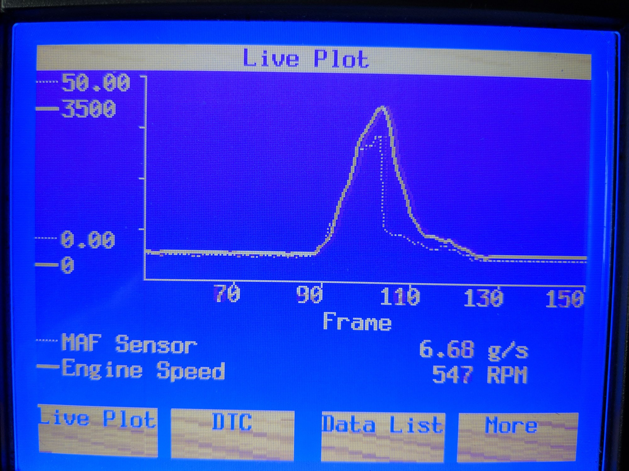

Fitted a brand new Delphi MAF (AF10043) 19th Jan.
With the engine warm, the Tech2 shows 6.5 g/s (0.014lbs) at idle rising to around 40 g/s (0.088lbs) at 3500 RPM (see JPGs)
