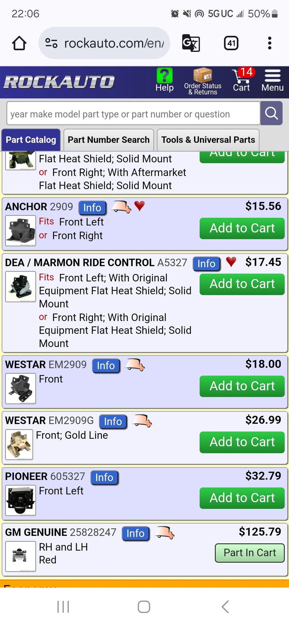

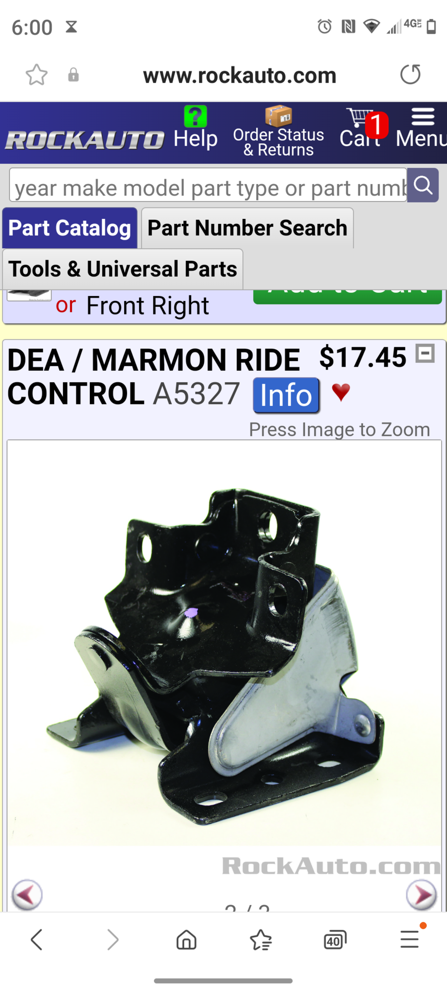

RockAuto has five or six different brands. The ones with the red heart next to them are the most frequently purchased. The one in the screenshot attached has the original heat shield on it.

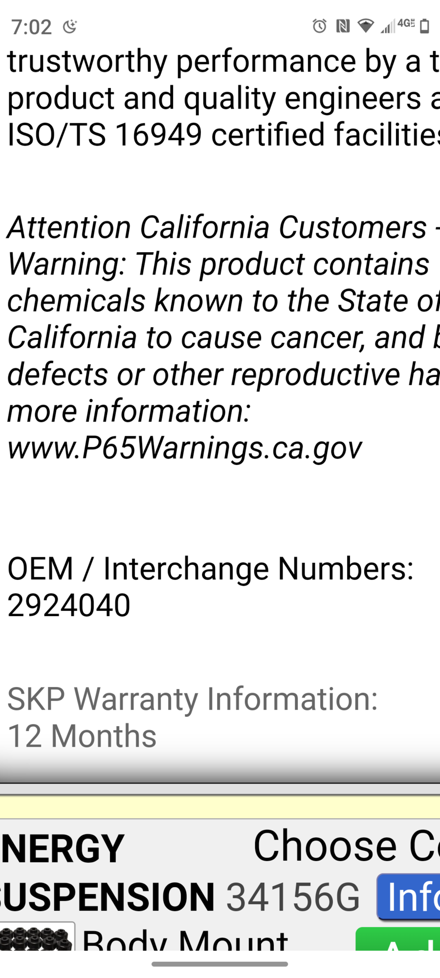

Here's an example from a RockAuto body mount kit. Your OEM part number is listed in the details
