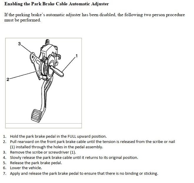

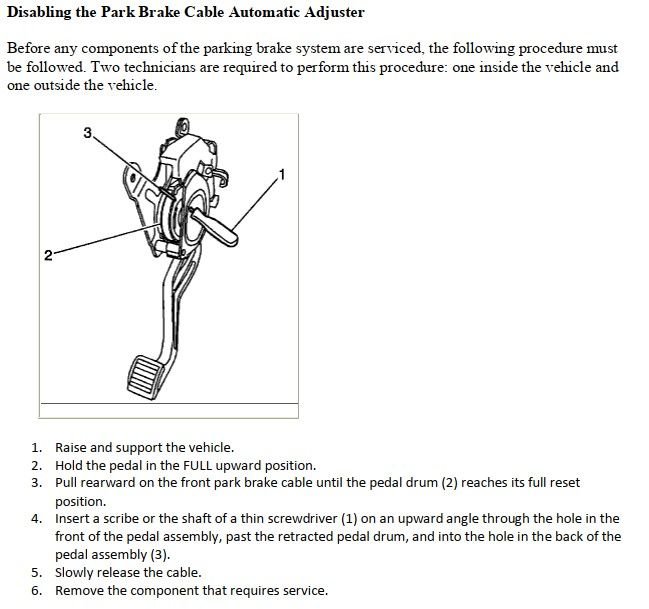

Old Feb 13, 2025 | 04:50 PM
oceanbrave's Avatar
Joined: Feb 2015
Posts: 1,635
From: Birmingham (UK)
@bronxteck
Interestingly that your info on the "Park Brake Pedal Adjustment" was missing in my manual, like it's been erased🤔
The above additional information I found on-line, but its hard to fathom how the "automatic adjuster" works, essentially there's too much play in the pedal before the cable engages.
One would imagine the cable should start to pull the moment the pedal is pressed or fairly close to it, but if someone could confirm this it would be a great help.
A while ago I had a rear brake cable snap resulting in the pedal going all the way down, to get home I had to lift the pedal back manually, perhaps this caused the loss of adjustment?
Looking at the above info, it looks like pulling on the front cable should somehow cause the adjuster to "ratchet back" to take up any excess travel, however its not clear how to do this.
Again if anyone has any experience and could let me know the procedure it would be very much appreciated 🙏
